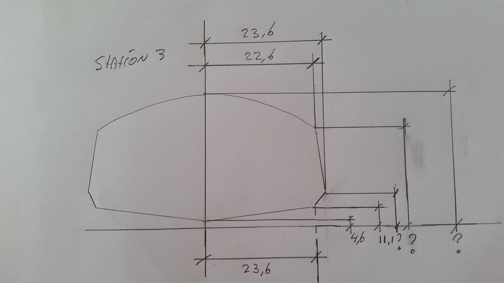

I think I'm starting to get is now (see pic), if so based on the table I'm missing some measurements, but that's probably me.
Base to top
Base to sheer
Base to chine
What's not clear to me why aren't they working from the keel or dwl but from a baseline under the keel?
Also I think I see a second step at station 15?

There is no inner chine at Sta 3, it starts right there. See the lines drawing. That is why the dimensions are the same. For the deck, it is customary to show the camber, the apex and nothing else.
I posted something last week on how to draw a traditional deck as a parabol.
It looks like you got it but watch out for that step.

I still didn't find those other dimensions
jacquesmm wrote:There is no inner chine at Sta 3, it starts right there. See the lines drawing. That is why the dimensions are the same. For the deck, it is customary to show the camber, the apex and nothing else.
What's an apex? also I don't see any camber on the side panels,there should be one I think?
Can you provide me the link to that post please?
jacquesmm wrote:It looks like you got it but watch out for that step.
Yes it's nice to understand it a little, but still I think I wait until your sons redesign of the Flyer, better safe then sorry

peter-curacao wrote:I still didn't find those other dimensions
Which ones?
No camber in the side panels except thoase coming from the conical projection but that is none of your concern, you draw the lines, not the surfaces.
Apex is the highest point of a curve, in this case, the centerline of the deck.[
The deck discussion is here:
http://forums.bateau2.com/viewtopic.php ... 21#p362944
better, see pic:
Step by step:
- draw deck beam = line.
- at CL, draw circle R=crown (that's in the offset table as deck height)
- divide horizontal R by 4
- divide arc by 4
- divide half beam by 4
- pull parallels to intersections.
- join by deck curve
That will produce the deck crown shown on the plans.
jacquesmm wrote:Which ones?
The ones on my drawing
jacquesmm wrote:(that's in the offset table as deck height).
O wait a minute now I see in the PDF, I'm missing a part of the offset table in my printed hard copy last 2 rows were cut of
