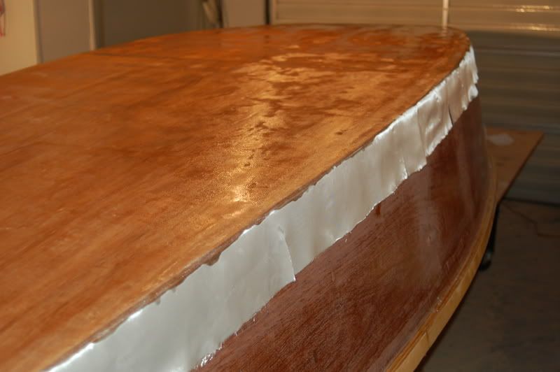

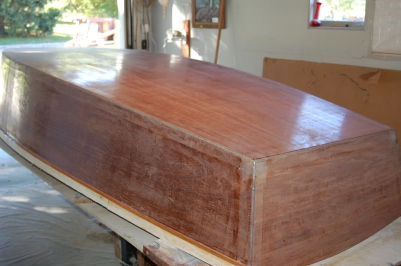

I have entirely coated the outside with epoxy and sanded her down.
I then started to draw out the Skeg but then decided to lay the fiberglass down first.

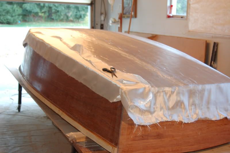

After my materials arrived last week I clothed her bottom in 9 oz. fiberglass and trimed it all around.
I then wetted out the bottom and left the overhang til last. I havn't got a picture of that wetted out yet, but that is where it stands.
I will next have to apply some more epoxy to her (now) not so tender bottom.

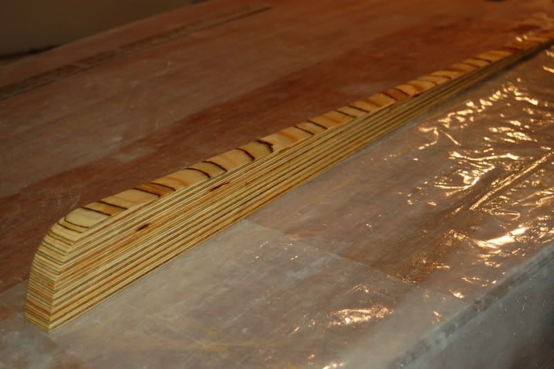

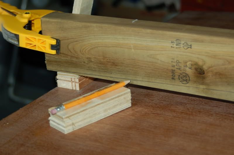

I've been spending the last few days working on my skeg. I decided to laminate the skeg to the shape of the hull. To accomplish this I simply layed down the first two layers of the lamination on a sheet of plastic layed on the hull of the boat. It works great. following find the link to see the progress. Next I will strip all the glue from the sides and scibe a line from front to back and make the cut. Then make the cut in the aft portion to follow the lines of the transom, and finally the radius cut. I'll then glass the skeg, and attach it to the bottom, make fillets, tape and finish it up. I have opted NOT to go with a marine Aluminum strip, at least for now. I think it will be OK.
