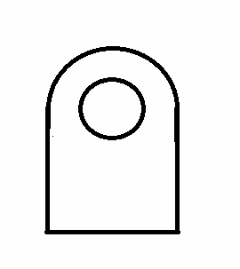

How bout 2 plywood rings (1 up and 1 down) like this on each frame? I don't think you can go cheaper like that.

The plywood ring should work fine, but both sides do not need to be rounded on the outside. Run one of those corners right to the hull side panel and fillet and tape it in. It would be plenty strong. Just put two of these, maybe each about an inch thick, in the corner of the frame, with the frame extended up to the sheer. :)
