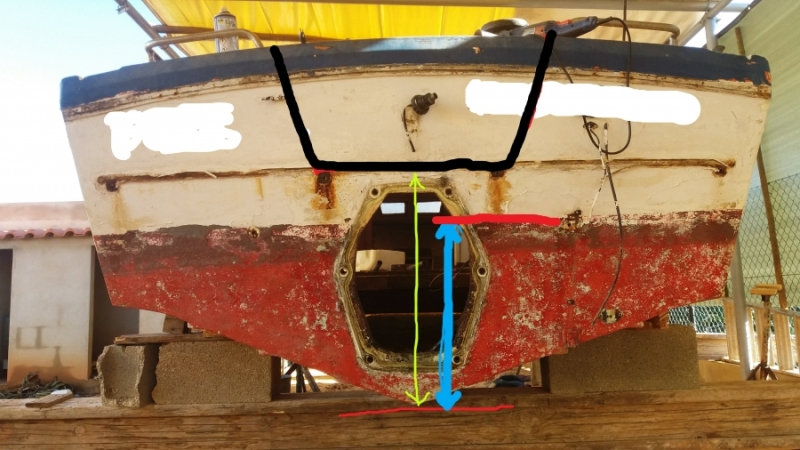

After somme search of bracket prices in my town,i realized that its overpriced for my budget..so my option is cut the transom like the image and put there a Yamaha 100Hp.. after my search on the internet, i found a yamaha rigging guide with dimensions.
- At black line, the future cut for the new transom
-blue arrow is the water line height (is at 50 cm)
- yellow arrow, the height described in the rigging guide (66 cm)

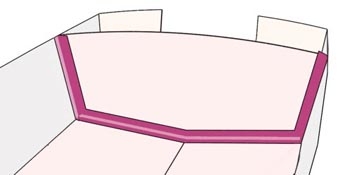

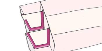

i found this fotos of fiberglass work on google, i think they are from this forum, but its my idea of what i want to do in this boat..

Okay, so you are using xtra long ob? And still only 16 freeboard?
Are these correct?
Are these correct?

i dont know if this is 100% correct..found the manual on internet so... here is fotos of what i have...fallguy1000 wrote: ↑Fri Nov 30, 2018 3:46 pm Okay, so you are using xtra long ob? And still only 16 freeboard?
Are these correct?
i sended an email to an outboard distributor to know if this measures are corret here in Europe..

663 is extra long shaft ob
536 is long shaft ob
Are you buying extra long version?
