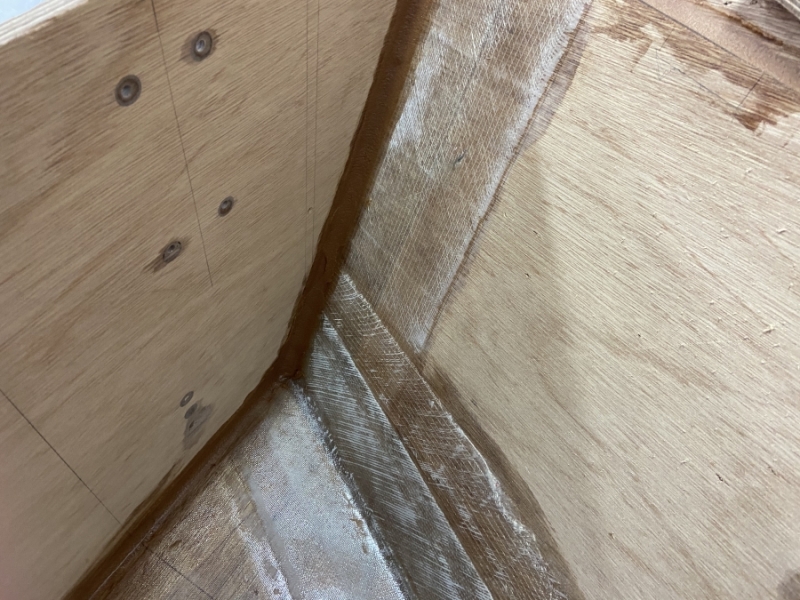

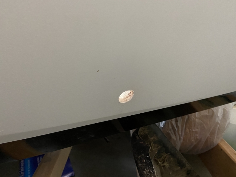

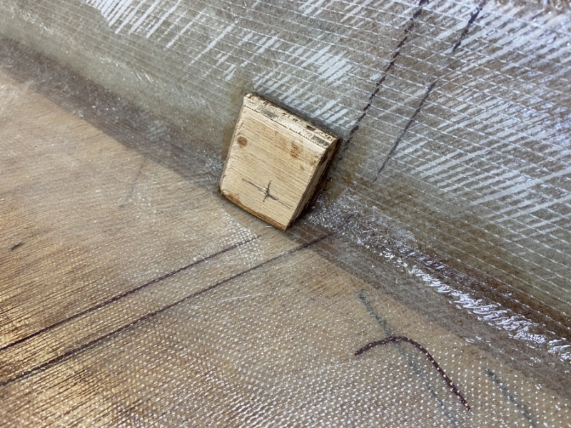

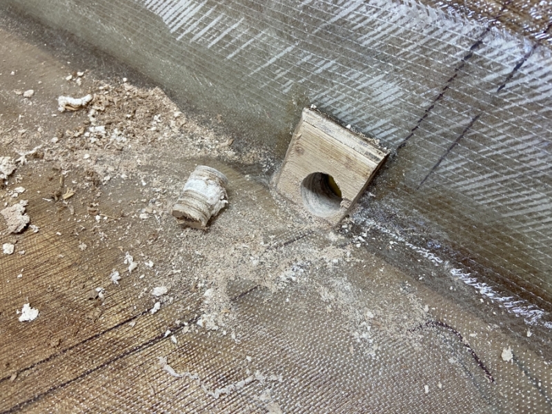

I glued a doubler on at the point I wanted to have the drain. Time to get on with it and drill that hole. I selected my sharpest 7/8" hole saw and went at it
There's a hole in my boat dear Liza!
Taped over the outside and filled it.
So far I have left it as a 3/8" hole at the bottom of the resin core. I can decide what to do with this later and can open it up from the outside now I have it located.
The aft bulkhead vent hole turned out OK and fitting the vent cover should be easy.

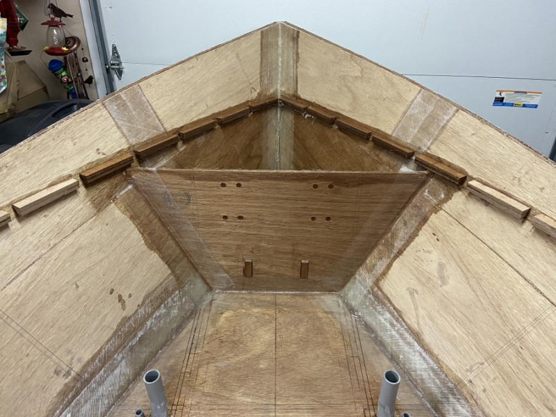

Cleaned up the anchor locker bulkhead and fitted the anchor stowage strap rings.
I gave the anchor locker a good sand to make sure I got a good bond and cleaned it ready to install the bulkhead. I did contemplate putting a sloping floor in the locker so any water would go toward the drain but that would have needed foam and a ply doubler to make the camber. I remember how heavy the flotation was in my GV10 once I got all the glass on it so decided against it. I was also worried that I may get trapped water under the foam and do more harm than good. I don't think there will be that much water standing in there and I know to mop it out.
Put in the bulkhead, held in position by all the other sub assemblies. Stir sticks used as spacers courtesy of Mc Donalds :) .
The bulkhead is now tacked in and hopefully I will be able to glass it in permanently late this week.
Alan.

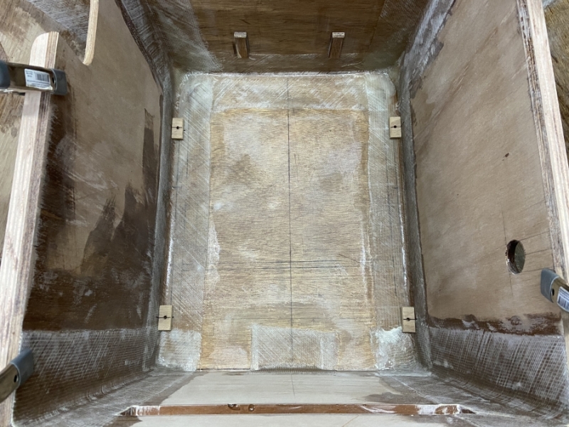

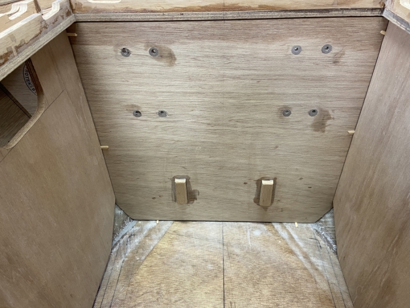

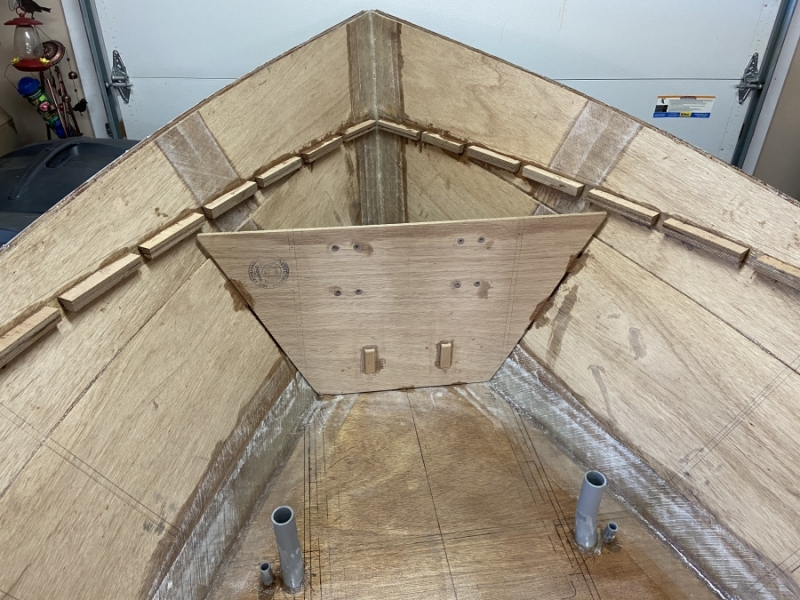

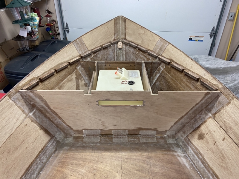

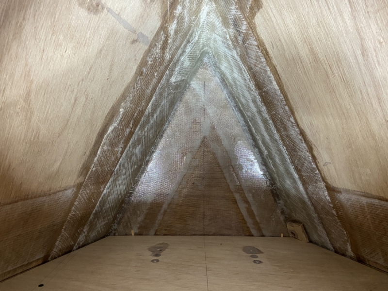

Didn't realize I hadn't posted for a while. Progress is slow now as all the parts a small. Tacked in the anchor locker bulkhead
The following day it was put in properly and taped both sides.
That's not going any ware. I lined the locker with 6oz cloth to give it a little protection from the chain etc. bouncing around.

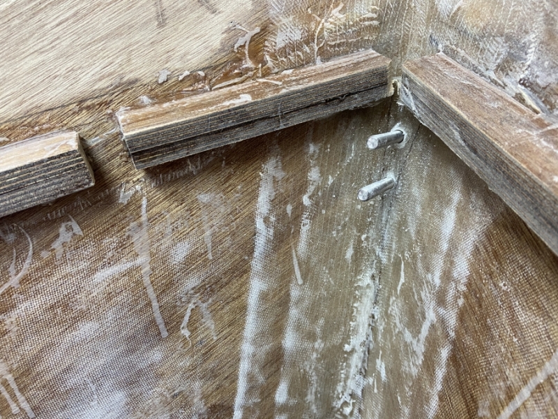

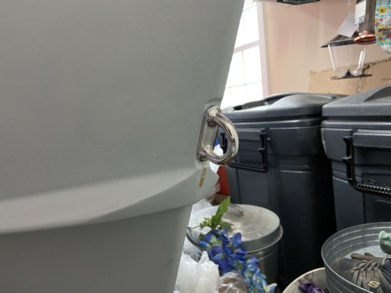

Realized I hadn't finished off the bow eye installation. Not a problem but glad I remembered. I'm impressed that I could find the jig I made to drill the holes. I normally put things like this in a safe place and never find them again.
I made a block from ply offcuts and bonded it into the bow to take the load from the eye. I drilled it all oversize and will fill and drill this when I next mix up some resin.
Anchor hangars finished and amazingly it all fits as I intended in the locker.

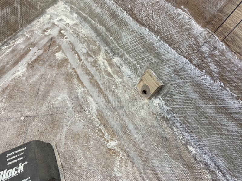

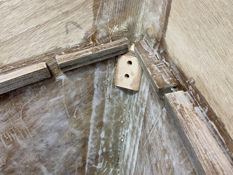

Cut all the glass tapes and installed the fuel tank locker and gave everything a good sand.

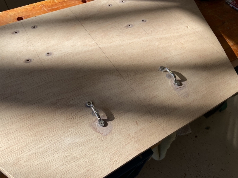

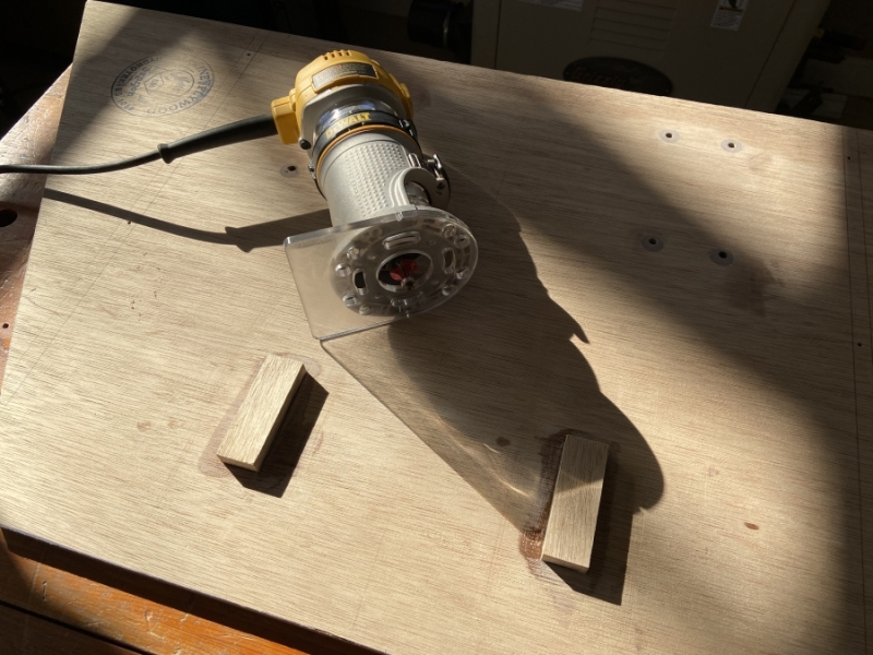

I made up some doublers from 3/4 ply offcuts to give a good glue surface for the deck when it eventually goes down. I rounded over the bottom corners in an effort not to have sharp corners to catch things on when reaching into the compartments.
Started making the mounting blocks for the fuel tank straps. My plan is to raise up everything I can that has a hole in the deck to help water run away from the hole. I don't know if this will make any difference but it makes me feel better.
