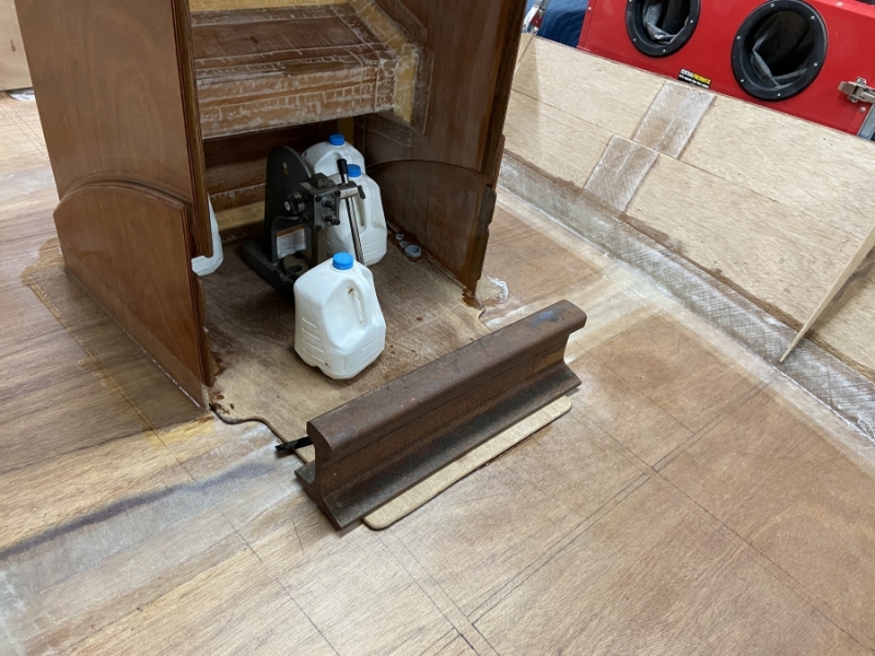

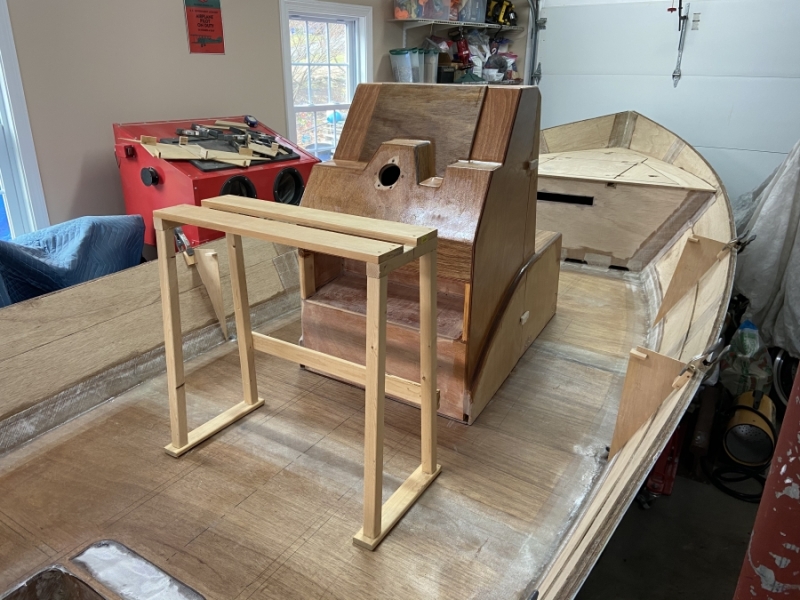

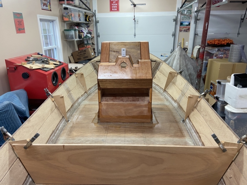

A little progress this week, but not as much as Salty :D I wasn't gong to install the console until I finished the forward lockers for access but I found I kept loosing days waiting for things to cure. This way I can alternate between the two jobs. Dusted off the console and mounted it on a couple of blocks to clear the chase tubes while I double checked the location.
Couldn't resist dry fitting the foredeck to see how it looked :D
Primed all the mating surfaces and bedded the console on a good amount of glue. I was amazed how much it took to get a good layer spread out with a notched spreader.
I put all sorts of things in it to get it nice and flat. Taped the sides and aft with one layer as per drawing.
After it had cured, gave everything a good sand and touched up a few bear patches with resin.
Alan.

Nice progress!!! Jeff

Nice detail on the console too

Real nice .How wide are u doing your gunwales ? And are u bringing them all the way to the bow or stopping at the deck ?

Nice job! That will be solid!
