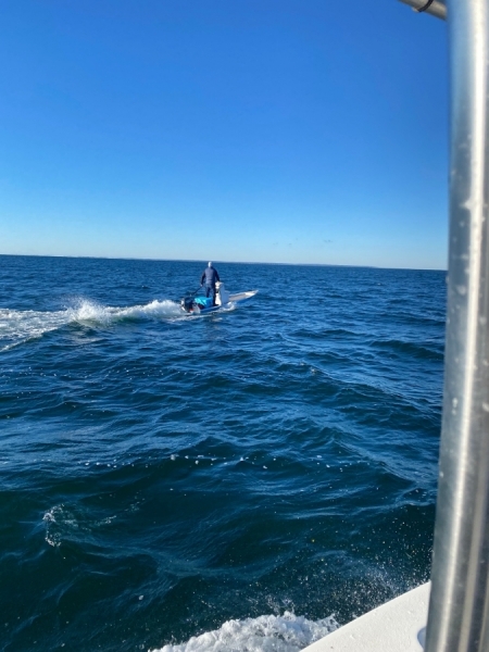

I send my little boat pretty hard and far, going places I probably shouldn't. But I overbuilt my little boat, glassed every seam, fill the entire thing with foam, etc.... I did 78 miles one morning in the Vineyard Sound chasing albies around the Elizabeth islands...
I just looked through your build thread, but it ended early so I cant see the rest of your build. but here is My 1.5 cents: Move your gas tank to the front of the boat, and make a tiller extension so you can position yourself a little forward while motoring around.
If you plan to use your boat in any kind of open water I cannot recommend plugging up the rear scupper. once the deck of your boat fills with water it changes the center of balance, and you'll flip the boat once enough water gets on the deck. With that big heavy engine, and your weight in the back along with the weight of the water, you will bury one of the back corners and flip over. Ask me how I know, and my scupper is wide open....
technically i didnt flip her. i jumped off the back and saved it from flipping. But If I didnt jump off the boat was going over. Im glad the back scupper was open, and once i jumped off all the water drained out, i climbed back on, started the engine and was ok
AND this happened 5' off the beach in 2' of water. Some giant triple engine tuna tower jackass was hauling ass chasing albies 50' off the beach, right while i was coming back into the water after beaching mini boat on the sand. his wake + surf put way too much water in the boat, more then the scupper could drain.....im glad it happened 5' off the beach and not 4 miles in the middle of the vineyard sound
If you plan to use the boat in calm back bays then do what you suggest.
