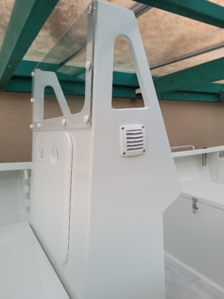

Well, I though I had carefully measured, but I had measured the first frame and had not realized that the following were slightly lower, so I had to shave a couple of centimeters off the windscreen frames... no big deal.

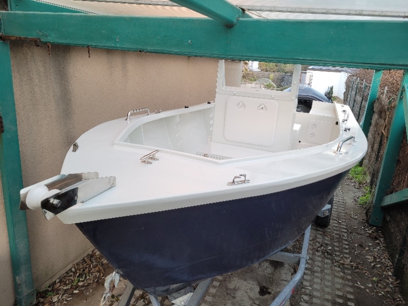

After a few weeks of drying, I thought that the top coat was good enough, only the transom will need touch ups. So I had a go at installing most of the deck hardware.

Re: C17 open in France
Your boat looks awesome. Love the layout particularly at the bow of the lockers.
My only comment would be that you will get lots of wear on your gunwales/ paintwork from the ropes if you leave those front side cleats as they are; perhaps mount them on a sacrificial piece of wood, or a small piece of stainless plate under them that contours round the side of the gunwale a little.
Tom
Thanks for the kind comments, and for the suggestion. You're right, the gunwale paint is somewhat exposed around the cleats and more protection would be useful. I doesn't worry me too much for now because the boat won't rest at the dock but will be launched from the trailer, so the cleats will see very little use, only for a few minutes while boarding / landing. I'm also about to add a rubber rail around the rubrails.

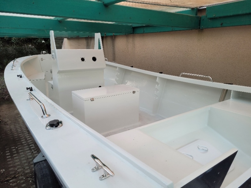

Back at work and getting closer to the finish line. The motor will be installed on Wednesday, along with the remaining controls.
In the meantime I have installed the rub rail (not finished yet), the swim ladder, the bilge pump and bilge drain, the pilot seat, the steering and a few other things, and touched up the hull paint where needed. It' too cold to glue the keel guard so that will wait.
