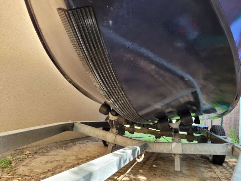

I've just installed the Keelshield that was laying around for some time. Man, that was hard, literally a pain in the back as I've been crawling under the trailer for 1 hour at least. An advice to all builders, do it at construction time while the hull is upside down!
It takes quite a few steps: dry fitting the shield, marking the perimeter with masking tape, cleaning, sanding, cleaning again, laying the activator, and finally gluing the shield on the bottom, center first, then both sides.
But I trust it will be worth it, the shield goes up to the skeg, so I should be reasonably protected against unforeseen encounters with the ground.
