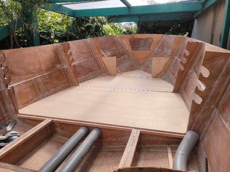

I'm aware the designer cannot answer this. But I was looking through other study plans and saw the pilot 21 is based off the classic series but uses a single panel side panel.
I've also seen jacq comment in other threads that the overlapping joint in the classic series side panel acts as a stiffener.
Ignoring efficient plywood nesting, is it possible?

Yes it is possible but it will result in a weaker side wall and a less pretty boat. If you want a single side build the OB17, nearly the same bottom, slightly less internal room. Tom

With the lower panel only, the sides will be very low, less than 12" of cockpit depth , probably lower that an FS17. Indeed you should look at the FS17 or OB17, I don't see the benefit of the C17 with a single panel.

I meant the same finished height side panel but in one piece of ply instead of the overlap. I'm going to assume the answer is no mainly for the stiffness it adds.

On the other hand - I dont see why you couldn’t build it with a single side panel an make it just as stiff as the two panel setup! 8O
If a ‘weaker sidewall’ is the issue - whack an extra layer of glass on it! :D

It's hard to gauge if the double side panel is
1) there for mainly stiffness added at the overlap
2) there because it's mainly a plywood nesting efficiency
3) the two smaller side panels are easier to bend to develop the curve at the bow.
I'm only curious since it was mentioned it can and is done on the pilot 21 after mentioning the hull is very similar to the c21. My assumption is either additional framing due to the pilot house or a thicker plywood is used for the sides.

The doubled over hull panels are great (especially when you hit the dock)
When putting together my C17 I was pleased to see how stiff that doubled zone is.
Great design.

The P/OP21 is very similar to the C17/19/21 hull shape aside from the single hull side panel. To account for the strength lost there the P/OP21 adds a half round stiffener glassed to the inside of the hull panel. It would not be impossible to use the same detail on the C17. Obviously this would be done a the builders risk.

Yes a stiffener may work, or adding extra side frames between the existing ones. Another issue is to draw the single side panels, the plans don't specify the overlap between the 2 side panels so it's not trivial to extrapolate the dimensions of the single panel.
