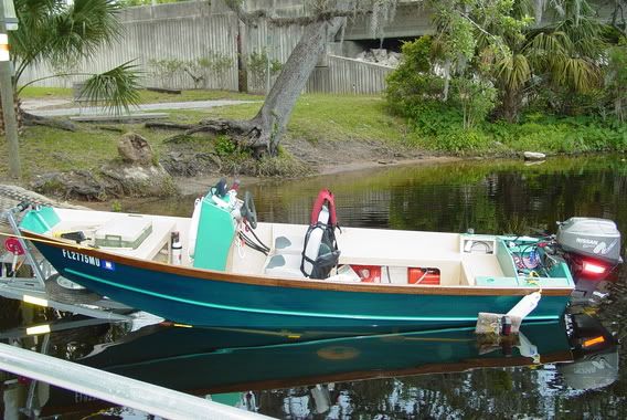

:( I now have about 24 hours on my GF-14. I took it out into the Gulf of Mexico around Cedar Key FL last week. (1st time in salt water). The water did not appear to be too rough, maybe 1ft swells, but there was some pounding & a LOT of spray. When I was washing down the boat I found a lot of longitudinal cracks in the paint. All the cracks were between the spray rails & rub rails along the center 1/3 of the sides, and most appear to be about 1 to 1.5" long. Most were on the starboard side, but there are also a few on the port side. The paint is Imron which I have found to be very tough & flexible in the past. Has anyone else had this problem? Any ideas as to what may have caused it?

What type of plywood did you use for the boat? Pine or Fir can cause checking, not sure that is you problem.

That's a nice boat, sorry to hear about the problem. I just wanted to add that painting over uncured epoxy might cause this kind of cracking. Learned that one the hard way. And if you use straight paint without priming, sometimes you can get bad adhesion.

It's not structural, probably cheap plywood checking.
Even the best paint like Imron can't help.
Solution: if you care about the looks, start with marine plywood like Meranti or Okoume.
Meranti marine 6566 cost less than marine fir around here.
If you use fir marine or exterior, fiberglass the surface with a light fabric like 4 oz. This will cost more than to start with Meranti and that is why we call exterior or marine fir a false economy.
At this point, there isn't much you can do, sorry.

I used marine fir, and a primer filler over epoxy that had cured for at least a week. I take it this means I will have to sand it back down to the epoxy & lay a thin glass cloth over the boat before re-painting it? I am more worried about water being able to get to the wood, if I knew it wouldn't happen again I would just put some clearcoat over the existing paint. Here is a link to more pics : http://photobucket.com/albums/v219/alegath/GF-14/
