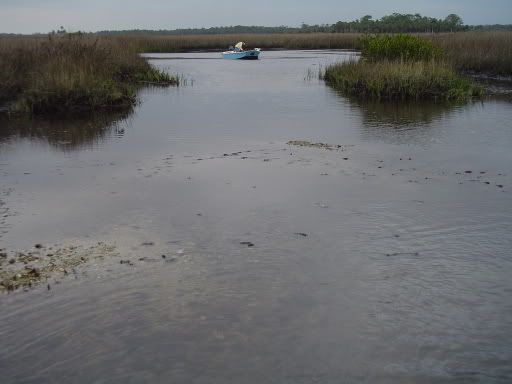

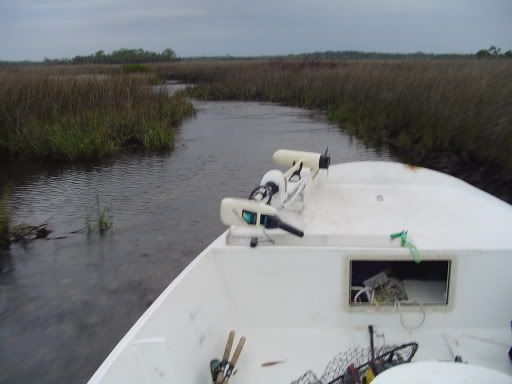

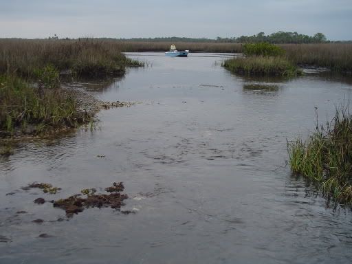

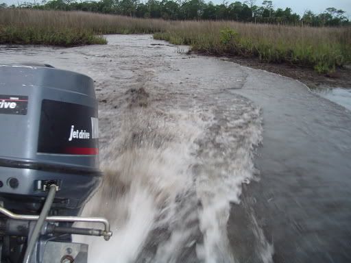

I think I might have over emphasized the X for "extreme" with my build of the XF20. Knowing the absolute insane abuse I was going to put mine through, I kept it as light as possible with as much bottom protection possible.
For some these may be old pictures but the proofs in the photo's Jacques designed the best bang for the buck skinny running boat there is period. Any doubters only need to "try" and follow me.
I got out and took photo's of what I just ran through, to give a better view.
Later..............Steve
