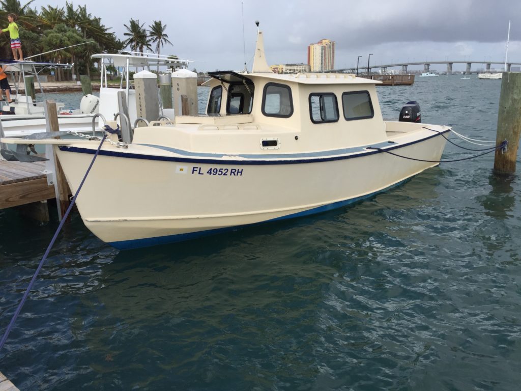

by Matt Gent
That bottom looks fantastic!
From my experience, the boat is a real handful to dock in any kind of wind - it always wants to point the transom into the wind, and doesn't turn up-wind well at all. Cp air is way forward due to cabin; Cp water is well aft due to keel. Especially with the OB on a bracket, turning upwind really needs to be planned. A thruster would be welcome in tight marinas.
The location is tough though - mine floats a little bow high. Bracket likely contributes to that, but I don't know that a thruster as shown would be always submerged. The boat generally runs better with weight loaded forward, which would help keep the thruster down.

Matt Gent wrote: Thu Oct 24, 2019 11:19 am That bottom looks fantastic!
It looks like you need to add a little lead forward to that rig.
Once you get crew on the back; she is cutting late. Lead will reduce your fuel economy, but the boat will handle better in the breeze.
Windage is an issue for many boats, but the bow must be down for that lightweight girl.
I suspect ballasting might result for the thread owner here as well if you fear the thruster gurgling.
The boat is lovely Matt. If you made me go sit on the bow for ballast, I would deserve it and gladly accept.
The picture may be the half story. Perhaps with the typical headcount; she rides much lower forward, too?
Anyhow, put four of your friends in the cockpit and you'll see for sure. My guess is a little lead is good. Wonder what Mertens says.
In my defense, it looks like water is on the splash rail aft, and we see your waterline 3" up in front.
Another option would be more chain on the rode, but I'd try some 100-200 pounds of lead.
The reason she swings is the front side is a sail. Another solution is a deeper skeg.
I am gonna go back and stare at the boat now. Carry on.

No progress on tabs. Still plan to, but not high on the priority list at the moment. I took a look at the Zipwake interceptors, think those would work well but just too expensive. Probably Bennet Bolts.
The anti-fouling line on my boat isn't straight, so that visually makes it look more bow high than it really is. But it is definitely light in front. There is no chance I will be adding ballast to the boat, but I do load it forward for bigger trips.

Matt Gent wrote: Tue Oct 29, 2019 9:51 am No progress on tabs. Still plan to, but not high on the priority list at the moment. I took a look at the Zipwake interceptors, think those would work well but just too expensive. Probably Bennet Bolts.
If you ballast; won't the splash rail come up out of the water and wouldn't you cut waves a bit nicer?

by Matt Gent
The splash rail on there is essentially cosmetic - too small to do anything. I plan to remove it when I repaint.
Tabs will help the balance and be variable by conditions.

Matt Gent wrote: Tue Oct 29, 2019 10:20 am The splash rail on there is essentially cosmetic - too small to do anything. I plan to remove it when I repaint.
Yeah. I suppose you can trim for varying loads or seas.
The tabs will run way down at slow speeds then and force the bow where lead would. Then at speed, you can just touch the water. I get it. Kindest regards. The boat is really lovely and I'd like a ride in it.
