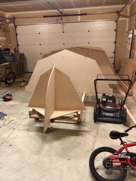

Molds and transom stacked in the garage.

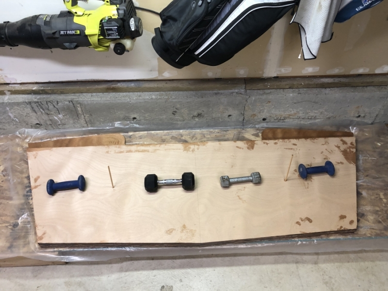

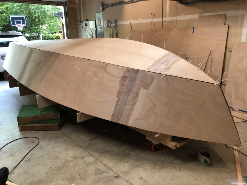

I was cutting out the hull panels today and just about done when I noticed the ply separating on one of the panels pictured above. I just picked up wood yesterday. It is Okume bs-1088. None of the other sheets I’ve cut have done this. I am planning to go back and ask that the sheet be replaced. Is this reasonable or should I just glue it myself.
Thanks

Scrappy, Absolutely!! Okoume BS1088 should not be splitting. What is the brand name of the marine plywood? Jeff
Thank you Jeff. The brand is Joubert. I just gave the lumber place a call and they told me to bring it in and they would replace it.

That is the first failure of a sheet of Joubert I have ever seen!!! Jeff

That could have been a lot worse. A builder on here had a ply failure on a boat after he had glassed the outside. Quality plywood failures are very rare, that's why we buy quality plywood. I'd carefully check the rest of the ply as well. It's possible that someone is trying to pull a fast one with respect to the brand.
Looks like a 'blow' where water contaminates the glue line of a ply.

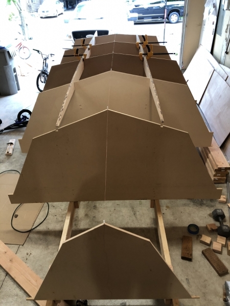

I got started on putting the molds on the strong back today. Got all the molds on minus the bow mold and the transom. Transom is not glued yet. I clamped the stringers together, as they are not glued either, and dry fit them in the molds. The one benefit of doing this is it made it really obvious which molds were off center. I started getting everything aligned and am almost there.

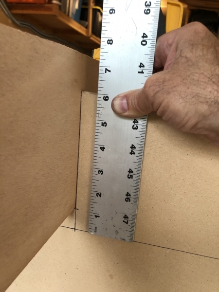

I have encountered one problem. The stringers are proud of the molds. I cut the stringer depth one inch shy of the baseline (bottom of sole panel in the case of the FS19). I did this so I can notch the stringers at the station locations. I have not yet notched the stringer so when I dry fit them I expected them to be about one inch proud of the molds. They however, are an inch and a half above molds C, D, and E. They are an inch above at F as expected. The pictures below might illustrate better what I am trying to explain. I went back and checked the measurements of the stringers and molds but I discovered this at the end of the day and need to apply a little more rigor. In the mean time if anyone sees a glaring mistake, please let me know.
Getting close to straight!
Stringer "sticking up" above mold.
Ruler, which hopefully better illustrates what I was trying to say.

Not to worry. The stringer issue cropped up in my build as well. Not sure of the cause, and I documented this in my build thread. Guy, may also have dealt with this.
Just remember that the molds’ locations dictate the shape of the hull not the stringers. The stringers at this point just help everything to align correctly. Fairness of the hull is the desired outcome. Fairness can be checked & verified quickly with a long batten.
The first thing to double check is the location of the molds on the strongback. The second thing to check is that the measurements/dimensions of the molds is correct.
If everything is correct then you may have to adjust the depth of the notches in some of the molds to accommodate the stringers. This was necessary on my build.
The stringers don’t get installed until after the hull is constructed and interior fiberglassing has occurred. Once the fiberglass on the interior has been applied, the stringers and the frames/bulkheads will all need to be trimmed/modified slightly to fit.

Browndog's point about hull fairness is critical.
Then on the inside; most soles reconcile to the waterline parallel. This may not be the case in some high speed planing boats that sit low astern before they are underway.
I don't know this build like others, but the boat is built fair and then the sole is built parallel to water. If the stringers are not parallel to dwl; then typically wrong.
When I built the station jigs for the Skoota, I used a self leveling laser and we drilled a 3/16" hole through the stations at dwl to help up tweak them. We actually ran two lasers.
Then as BD suggests, I walked around with a batten and realized some of my stations needed beveling. This was a female mould, so a bit different.
I can imagine notch cutting stations would have a similar potential where measuring the stringer cutout closer to the keel versus the chine could drive some variation of a half inch.
Ultimately, the stringer top to the dwl measures should be the same (if the stations are the same waterline level). You can measure these and write them on each station.
Please forgive me, I do not know how the baseline and waterline differ for this boat.
And use my reply with a grain of salt and conversation instead of cutting plans.

I fretted about the stringer issue for a while, triple checked everything and then adjusted the notches in the molds so the stringers would sit flush. Thanks to Browndog and Fallguy for advice and encouragement.

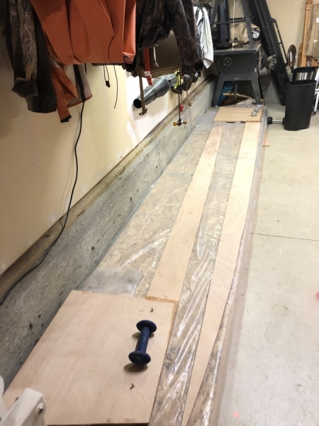

The epoxy supplies arrived and I glued up the stringers. I used the dowel method described by others on this forum. I used six dowels per stringer. Not sure if that was overkill but it kept everything aligned.

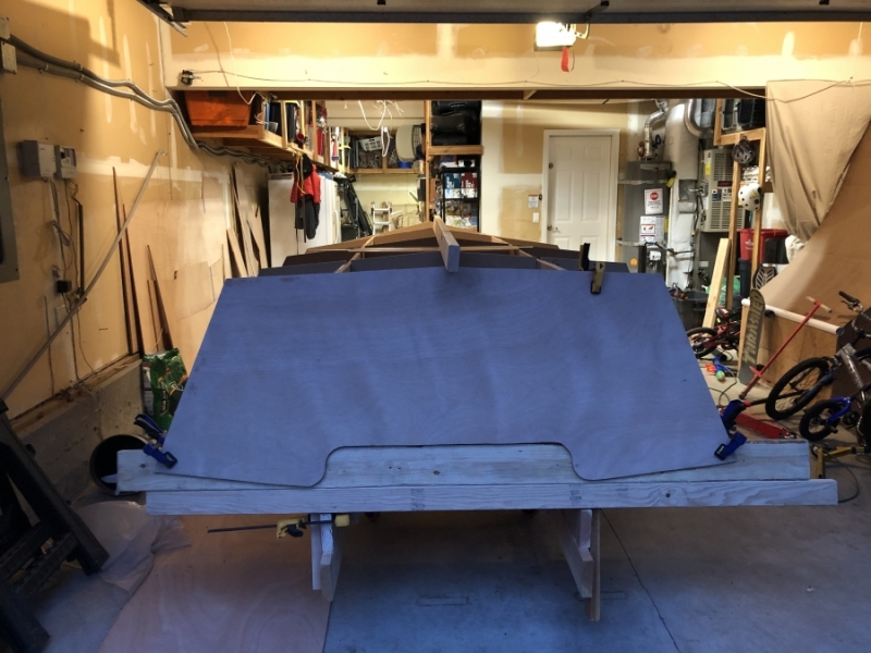

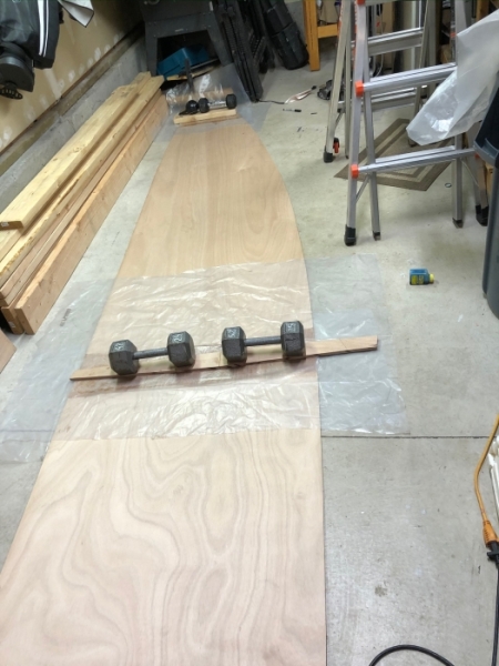

Spliced the other side of both bottom panels today and started on the bracing for the transom. Will get it mounted on the jig tomorrow, I hope.

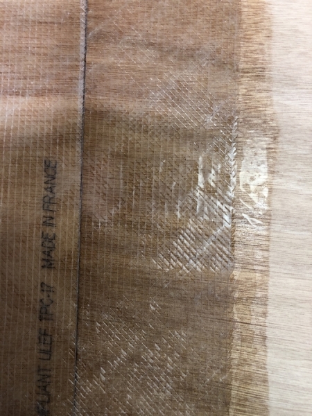

I’ve been experimenting a little with the epoxy/fiberglass. Having read so much about not using to much resin, I’ve been trying to get the feel for what is the right amount. Should the resin completely fill the gaps in the weave or is it OK to have “sunlight” in between the weave. In much of the attached picture the space between the weave does not have resin in it but I believe the cloth got saturated. Did I use to little there?
Re: FS19 in Sherwood, OR
Posted: Fri May 15, 2020 8:36 am
by OneWayTraffic
If the glass is saturated everywhere it will be ok. But you will need to fill that later anyway. In my view using a bit more resin than needed is better than using less and having dryspots or air bubbles. What worked for me is to pour it on generously using the chip brush as a shovel, or just pouring from the pot. Spread with the squeegee or brush and give it time to soak in. Then try to remove excess with bubble roller and squeegee and transfer this excess (it will be foamy with bubbles) to another pot. Either discard, or mix with filler and use to fill weave somewhere the glass has gelled (it needs to be at initial cure before you can do this) or make a fillet or something.
Thanks OneWay.

One other thing. If that’s a panel splice then you need to put thickened epoxy in between the panels. Then glass over so there’s no gaps or voids. It’s not clear if you have done that or not. I did not do this in my initial spliced and had to patch drill and fill later. Wasteful and more work.
Upper side panels of my c17 I had learned. Mixed only what I needed wet out the tape on plastic and primed the wood. Thickened the rest and then lay a tape down under the splice on plastIt so it doesn’t stick to the concrete. Then panel on top, Mayo thickened epoxy in the join then tape on top. Then plastic, some flat wood and 6l of water jugs as weight. Worked much better and done in a day.

White glass is generally not enough resin.
If you use a consolidation roller; it will usually do the trick.
My boat has scary low amounts of resin, but none of the matrix is white. I hope I am not gonna be in trouble for it.
For hand lamination, I almost always use the same amount of resin as glass by weight. And it has worked many times. Usually, for a bigger job, I find that to be a little too much, but on this project; we rarely spill much epoxy.

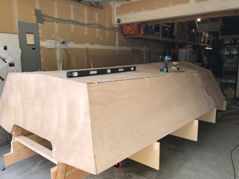

Started stitching today. Had a really tough time once I got forward of station B. The bottom panels pull together and form a hard point about 2’ long forcing the keel seam to rise up off the mold at Stations B and C. Stitched and restitched for a couple of hours and convinced myself I had messed up the camber there somehow and needed to trim the bottom panels. Decided to take the kids and dog down to the river for a dip instead. Figured I’d sleep on it. The good news is I think it looks great everywhere else. Fair, no waviness or hook or rocker that my untrained eye can detect.
Posted: Mon May 18, 2020 5:38 am
by cape man
How far off the mold?

If you use the motorwell sides as I specify in the drawings, there is no need for any alignment. It falls in place automatically. Anyway, from the pictures it looks perfect. To line up as you did is good too if you leave a gap equal to the thickness of the bottom panel. The transom sits between the bottom and side panels.
Posted: Mon May 18, 2020 1:13 pm
by jacquesmm
The gap between the molds and the panels is fine.
Make certain that the beam at the sheer is correct, the sides tend to flare open.
About gluing the transom: everything is welded with epoxy, no gap. The screws are temporary.
For the glass, less resin is better but all the glass must be wet with resin.

I would like to follow up/ clarify the issue with the bottom panels near the bow. I have a nice uniform gap along the keel seam from the stern all the way up to around station B. When I pull the bottom panels together at the bow the bottom panels push against one another and rise up off the mold. It is not very much, an inch or so but the bottom panels are touching along the seam for about 2 feet. And when I say touching, I mean the force is so great that the small nails I am using for spacers are pressed into the wood allowing the panels to contact one another. I briefly tried larger nails to keep a gap but the panels then just kept overlapping by a half inch or so. I think I could probably get everything aligned with better spacers but I thought that having those panels under such compression ( not sure of the correct force term) was undesirable, even detrimental.
Incidentally, when I pull everything into place all 4 panels line up perfectly.
Do you recommend trimming the panels along the seam (probably up to a quarter inch of each panel) where they are contacting or gluing them in place as they are, with a gap of course, but with the high force of the panels pushing against one another?
Thanks for your time and consideration. I really appreciate the help.

Stitched!
Posted: Wed May 20, 2020 11:56 am
by jacquesmm
It looks done and the fit is nice. Good job.

I ended up trimming the bottom panels. I made a couple of attempts to stitch them without trimming but fighting the overlapping proved fruitless. I tried sanding them down while they were still on the molds but that was getting sloppy and asymmetric. Finally I let them overlap and traced where they met, then pulled them off, clamped them together, hand drew, the best I could, a fair curve halving the traced overlap. Trimmed them and put them back on and everything fell into place. No panels are touching although they are still lifting off the molds a little forward but I am really pleased the way it turned out. Over the last two days I glued the bottom and side panels to the transom and started filling the panel seams with EZ fillet. Ordering some more resin and the fiberglass cloth today. I plan on glassing the entire hull, wet on wet over a 48 hour period prior to the end of the month.
Thanks for the replies and support.

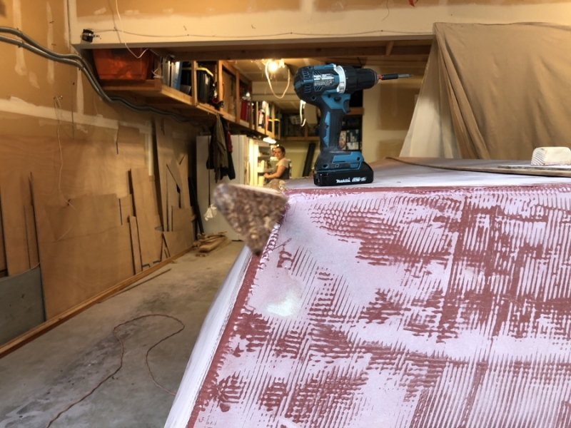

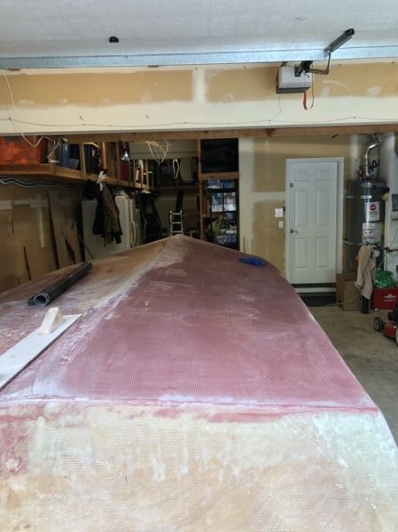

Finally got a coat of fairing compound over the entire hull using the notched trowel method. Continued sanding; my method has been to sand first with the random orbital sander then when I've knocked down the highs and I feel the ridges are close to fair I switch to the fairing board. I work station to station, making 4 passes with the fairing board, first working at a 45 degree angle to the longitudinal axis, then the opposite 45, then two passes, one parallel and one perpendicular to the long axis. There is still a little work to do on the bottom panels near the transom and the side panels at the bow, but the ridges are fair over the majority of the boat.
Next steps are to add the rub rail and spray rails. Then fair in the rails, fill the ridges with fairing compound, sand again, then a final coat with EZ fairing compound.
Started on the spray rails today. I had shaped them from 20' clear cedar 2x2s. The process started out easy enough, I used temporary screws put the spray rail in place, leaving it about 1/2 and inch off the hull, room to apply the Gel Magic. However, after I had applied the glue, because my rails are triangular, but not quite isosceles, and I had started the screws through the outer vertex when I attempted to screw them tight to the hull there was a large gap between the rail and the hull on what will eventually be the top side. Luckily my wife and 12 year old were home and they helped me while I quickly removed and replaced all the screws to get the rail to sit flush against the hull.

Looking good. You’ll love getting that first coat of primer on her. All of that fairing blotchiness disappears. I held off with any fairing until my spray rails and strakes were taped in.

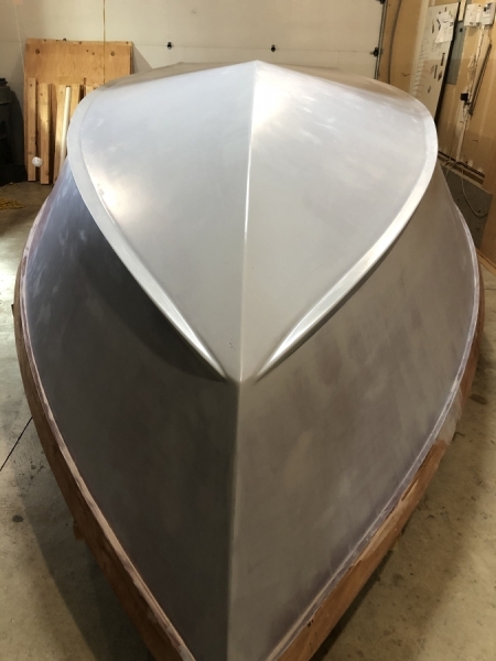

Finally ready for primer and paint. Put a thinned coat of epoxy over the entire hull today. Overall I am pleased with the results of the fairing and sanding, the only exception is there is a little waviness where the spray rail meets the hull. Wasn’t obvious until I put the epoxy coat on. I am going to get a coat of primer on and reevaluate before I add any more fairing compound.
The fires out here in Oregon have ruined my elk season so I’m going to hopefully prime this week instead. Waiting on the primer to arrive I ordered last week. I’m going to use the system three yacht primer and EMC quantum 99 paint. Rolling and tipping. I know very little about painting so any advice is welcomed. Specific questions I have is what grit of sand paper should I use for sanding between primer coats and paint coats? What kind of brush to use to tip?

Looking great! I used foam rollers like these:
https://boatbuildercentral.com/product/ ... er-2-pack/
I was able to buy 10 packs at my local hardware store.
I found these worked great for both the System 3 primer and the Awlgrip.
I tried both chip brushes and foam brushes for tipping.
I settled in on foam as I could throw them away and did not have to pick out the loose hairs that always came loose on the chip brushes!
Good luck with your finish!

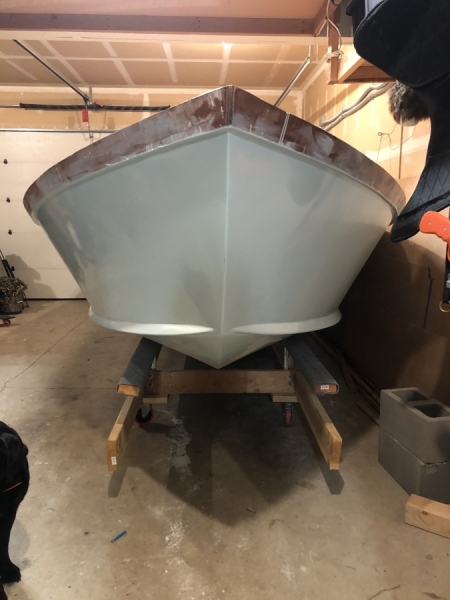

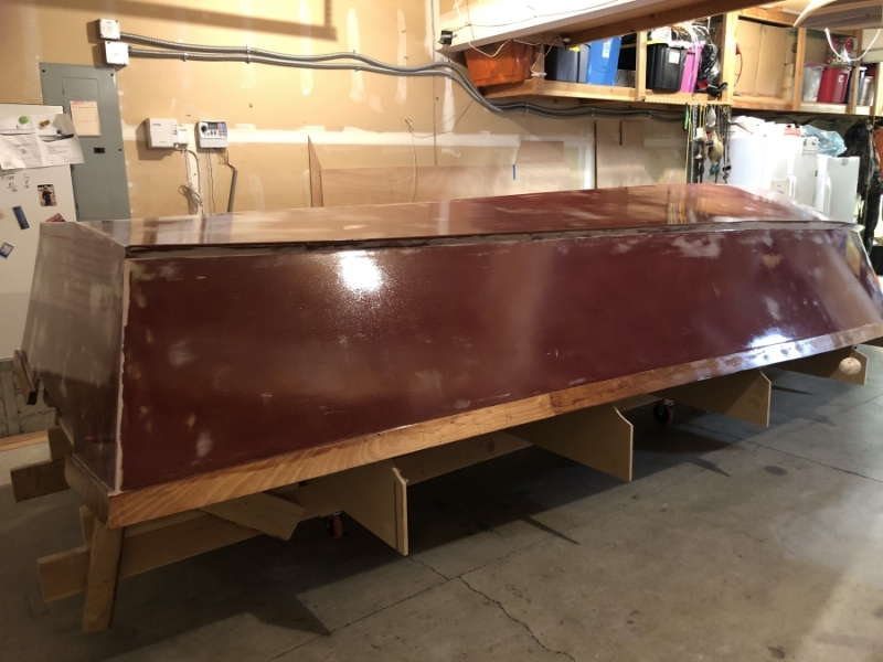

Finally got the hull painted and flipped. Was a little frustrated painting it. I’m not a good painter and took about 7 or 8 coats(I lost count) before I decided it was good enough and was ready to move forward. Glad that part is done and I’m moving on.

I know the feeling. Look into vinyl wraps. As long as the surface is fair and smooth they cover well, can have some cool designs to catch the eye, and aren't that expensive compared to top quality paint.

Congratulations on the flip!
The boat is looking great. Happy to see another FS19 project moving along nicely.
The whole sanding, fairing, priming and painting process is really tedious work that takes time and effort to get right, but makes you feel like the project is kind of standing still.
Now that the boat is flipped, you will get to do a bunch of interior construction work that will make it feel like things are moving again for a good while.

Always fun to cross the 'its painted' bridge and the 'flip'.
I am fairing forever it seams. Hehe

Scrappy wrote: ↑Mon Mar 08, 2021 1:12 am
...took about 7 or 8 coats(I lost count) before I decided it was good enough...
Good GOD Man!
I admire your commitment.

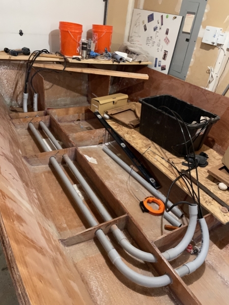

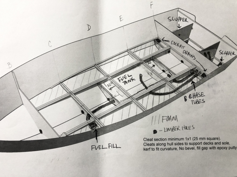

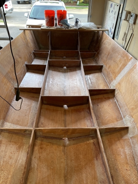

I’ve been doing a lot of planning for the layout of my boat. Stealing most of my ideas from the experts on this forum but I thought I’d share my plans and throw some questions out to make sure I’m not doing anything stupid.
First, I plan to install a v-hull tank beneath the sole. I will need to move the center frames on either side of the tank (D & E) out 12 inches to accommodate the tank. The size of the tank and location is such that the engine rigging will need to run over the fuel tank to come up under the center console. The current plan for the dimensions of the tank will give me 3 inches of clearance between the top of the tank and the sole. Any problem with the chase tubes for the engine rigging and electrical conduit over the top of the fuel tank?
I plan to have limber holes in all the center frames. I plan to foam all the compartments outboard of the stringers, with one exception, but that will mean foaming over/around the chase tubes. Is that OK?
To install cockpit drains plumbed to scuppers, I plan to add an additional frame, outside the stringers just forward of the rear bulkhead (F) and foam only forward of it. Does that seem reasonable?
Additionally, I plan to store the batteries underneath the center console, any issues there?
I’ve included a rough diagram below for reference.
I appreciate any thoughts anyone has.

I am not familiar with Mertens allowing the move of the transverse frames to that degree. Most of the time, the glassing of the inside skin requires extra glass to make the change you suggest. But it may be within limits. Only the designer can say yes. Or he may say add a layer of 1700 in the tank area..
The rest of the plan seems fine. Personally, I'd be a little careful about allowing enough space for tank expansion so the chase isn't noisy on the tank in warm weather. And with batteries above a tank compartment, I'd be inclined to vent the battery box and avoid mechanical switches that may spark. I don't believe batteries are NOT allowed above a fuel tank under abyc rules, but a fuel system component is not allowed above a battery, so your fuel lines cannot run above the batteries.
Posted: Tue Apr 06, 2021 6:24 am
by Dan_Smullen
Turning the chase tubes up 90 degrees within the ~3” of clearance between the tank and the sole may be tight. Unless the console will be wide enough to capture the open end of the tube, outboard of the stringer, it’s hard to see a different configuration. I too planned for 3” of clearance, but wound up with a little less than 2-3/4”.
What’s the plan for bedding the tank?
I had resigned to only add foam that were completely sealed, therefore no compartment with a chase running through it, due to lack of confidence sealing the penetrations, but I’ve since gotten over that. Popular opinion is such that thickened epoxy will adhere to scuffed /flame treated pvc sufficiently to seal the penetrations.
Thanks Dan, I’ll be sure to do some testing with the chase tubes before I commit to the tank size. I don’t think the console will extend beyond the stringer but that would make things easier.
For bedding the tank I planned to bond reinforced plastic strips to the bottom of the tank and then bond that to the reinforced hull. It is a method recommended by the tank supplier, adopted from a book written by David Pascoe. But still learning and open to suggestions.
Is thickened epoxy preferred over 5200 to seal the chase tubes through the stringer and frames? Also if I run the fuel fill, vent, and pickup lines before I put the sole down is there any reason for chase tube? I suppose I’d need them in the areas where I plan to foam in case of needing to replace them later.
Bear in mind, this is my first time building a boat, but I have been fortunate to have gotten advice from experienced, professional builders. I was advised to not bed the tank on the inside of the hull, but no reinforcement was discussed. I'd trust the book you've read over advice I got. As suggested to me, I bed a fiberglass encapsulated piece of 1/2" plywood parallel to the waterline where the bottom of the stringers meet the hull, with limber holes draining to the bilge front and back. On this, between this and the tanks will be 1/4" neoprene rubber strips. I believe drainage around the tank is a important as the tank being secure. I imagine, that all of the clearance, above and below the tank, could easily eat into capacity by 20% or so. I found 2 smaller tanks was better than one large as they accounted for all required clearances without moving frames.
Scrappy wrote: ↑Wed Apr 07, 2021 10:43 am
I don't know, but glued in my first piece of PVC last night, but haven't checked it yet. I like the chase tubes. They protect the epoxy on the plywood and the hoses from chaffing.

Quick update, the silica thickened epoxy around PVC is remarkably tight. Seems to be very strong.

I used a 35 Gallon V-hull tank under the sole in the FS 19 that I built.
One of the reasons I raised the sole by 1” was to provide clearance for all of the fittings and fuel hoses etc., there is very little space under the sole as designed.
I bedded the tank on neoprene strips as recommended by the tank manufacturer.
If you put a tank under the sole you will need to add another layer of Biaxial glass on the inside of the hull where the tank will rest per the building notes and the designer.
I moved the transverse frames between the stringers to accommodate the tank and left the part of the frame that was on the outside of the stringers. I also added support under the sole to stiffen the area above the tank and to accommodate mounting points for the leaning post.
In my recollection there was no room above the tank for chase tubes except for a very small one for the fuel sender wire to the gas tank fill gauge and the ground wire. My chase tubes were installed on the outside of the stringers.
My build thread includes a large number of pictures of everything I just tried to describe and would encourage you to look at the thread for whatever details that I might have forgotten about.
I would strongly recommend that you mock up a console out of cardboard before you buy any materials for it. I changed the console a few times before getting it the way we wanted. After putting the hull together, building a console is a piece of cake.
I also recommend dry fitting the sole in place before finalizing the interior design. You may find that you will want to move some stuff around or change the dimensions of the front deck and it is hard to do once the sole is glued down. I shortened the front casting deck and added a rear deck on the one I built.
Fell free to call or message me if something isn’t clear to you.
Your boat is looking good. Keep up the good work.

Scrappy wrote: ↑Tue Apr 06, 2021 12:34 am
Also, does anyone know where I can find center console plans to get me started? At one point I thought I remembered seeing someone had posted a rough sketch with dimensions but can’t seem to find it.
There are console plans here if you have not found any yet
https://www.boatbuildercentral.com/prod ... use-plans/ They have been designed by Jacques and fit different size boats.

by Scrappy
Got the inside of the hull glassed and the stringers and frames, minus the forward two, glassed in as well. Next step for me is to put an additional layer of glass down where the fuel tank will go. It will sit between the offset center frames in the photo. After that it’s chase tubes, foam, and thru-hull fittings.
I ordered a 115 Suzuki that will take about three months to come in. After some frustrating searching around I found a really great dealer that was willing to sit down and talk about my project and answer all of my stupid questions. He wanted me to put a 3 in chase tube in but I think that is to big for my stringers and frames. He agreed to give me the wiring harness and separate hydraulic steering line in advance so I could run that through the tubes before I get the sole down. Still considering it.

by Browndog
For the extra layer of biaxial under the fuel tank I used all of the scrap pieces that I had leftover from glassing the hull per designer recommendations. Not the prettiest glassing job but it is completely hidden so cosmetics were not required. Save the good stuff for the visible locations.
On my build there are two PVC chase tubes on the outside of each stringer. One side for electrical and the other side for fuel and steering. The two inch diameter pipes were more than adequate. Used a builder’s flexible fish to pull wires and hoses through. The hydraulic steering hoses are probably the least flexible of what needed to be fished from the console to the motor. Having an uncluttered chase tube for them was helpful.

by TomW1
Scrappy chase tubes need to be sized for what you are sending through them. Normally a 2 - 2.5" for control cables, another 2" for steering cables, you do not want to combine the two. Then a 1.5" for fuel and a 2" for electrical, and another 1-1 1/2" for depth sounder, it needs to be separate from electrical interference. Control cables and steering cables should not be in the same chase tubes as they will wear on each other and cause chaffing over time. Run the top of the chase tubes 1/3 to 1/2 below the top of the frames. Make sure you have a couple of inches between the chase tubes.
I love the FS19 and helped GuyP prop his FS19 properly. Once you get to that point and you would like my help please feel free to ask. A Suzuki 115 is a lot of power for an FS19. A 115HP pushes a much larger and heaver C19 into the lower 40 mph' range. With a 600lb less hull weight and less v at the transom the FS19 would have a top speed close to 50 with the 115.

Got the first couple of chase tubes fitted and did a test run sending the rigging through. It went pretty good but I did need the fish tape for the control cables as the threaded ends kept hanging up at the last corner.
These two are 1 1/2” conduit. One houses the control cables and hydraulic steering tubes. The second houses the engine wiring harness and I will also run wiring from the battery forward to the bus bars through it.
I’ve been researching marine electrical systems since my practical knowledge of circuitry ended in 6th grade science. Newboatbuilder.com has some good info and there’s some great YouTube videos by Jeff Cote from Pacific Yacht Systems.
Next step for me is to pull all the tubes out, clean up the holes and seal them with epoxy. When I reinstall the tubes I plan to seal the frames and stringers with 5200.

Fuel tank arrived and dry fitted. Sits nicely in the hull. It is 36 gallons. I think I could have squeezed in a few more gallons but erred on the conservative side with the dimensions to ensure I had adequate room for installation.
Raising the sole an inch. Ripped an inch off 2x4s and using a dado to grove them to sit on top off the stringers and frames.
Glued in the first full bulkhead.

I’ve gotten a little work done over the past few weeks. Chase tubes are all in. The fuel tank is installed and the cleats along the stringers, frames, and hull for gluing the sole down are in. Started pouring in the floatation foam yesterday. Hope to get the sole cut and dry fitted this weekend.
