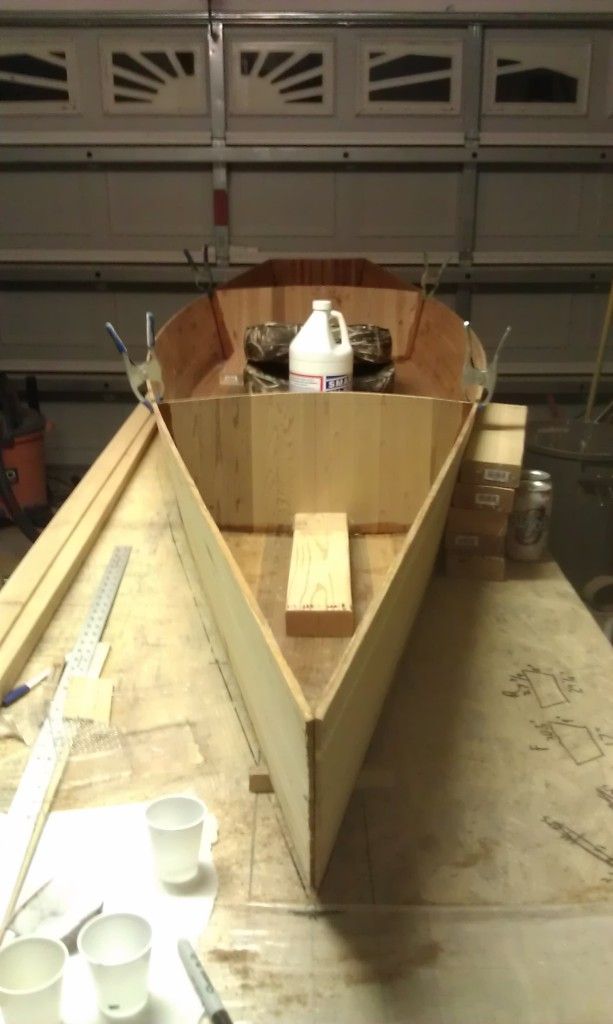

I responded earlier but I guess it never got through. I actually picked up a seat this morning. This is a different beast altogether now, lol. The extra width will change the balance point as well as the tail. However I think it will still end up about 12-16" aft of the midline. We will see soon.
Started on the bulkheads, I hope to be able to tack them in this evening.

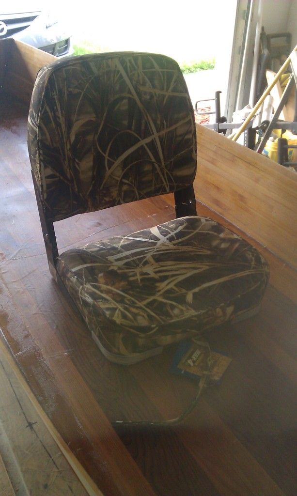

I also picked up a seat, I went to buy one in a cream color since I am painting the interior that way, but all the off-white seats just looked like the bright ones next to them. So I decided to go camo. It has the cream color in the pattern I'm looking for so it will tie in the interior to the browns of the wood. It will be easy enough to change later if I decide I don't like it. What do you guys think?

Looks pretty good! Throw in some decoys and a shotgun. Watch out ducks!

It looks like a duck boat, but I don't hunt, lol.
I tacked in the bulkheads. I decided to add a slight radius to the tops, I think it will be more aesthetically pleasing and add a slight bit of strength.

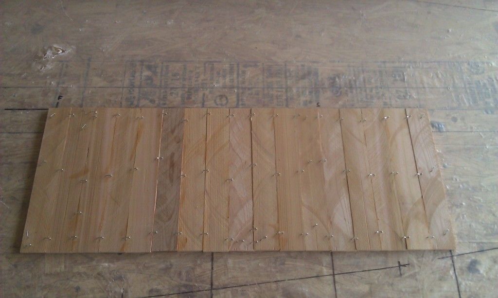

I had to cut a bunch of strips, some from 2x and some from 1x, to finish up the boat. Honestly that is the worst part, cutting all the strips takes forever, then having to piece the panels together. If I built from luan panels it would have been assembled in a weekend, but it would be heavier and not nearly as cool.

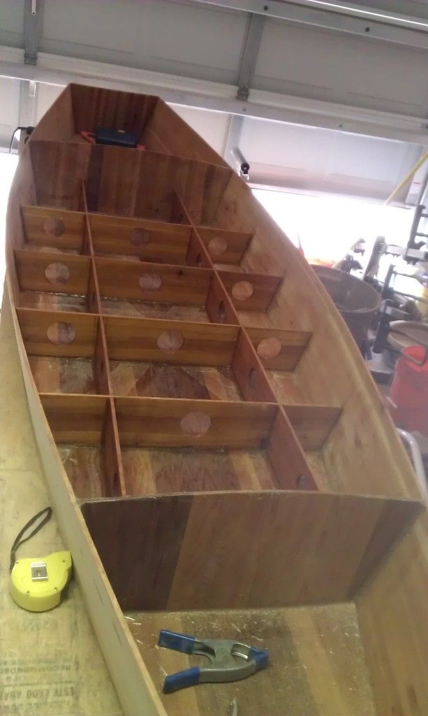

I started working on the interior support structure. I redid all my draft calculations, I calculated out the area station by station at 18". I used several different methods to try and find the draft and got a range from 3.2" to 4.1", however that is at 350lbs total load. I seriously doubt I will ever exceed the 320lbs mark but wanted to figure high. I decided to make the sole 4.75" so it will be self bailing after all. I may have gone a little nuts and over built it.
Test fitting
I decided to lighten the supports a little by cutting some holes, it won't effect them structurally as they are overbuilt anyway. I will be using floatation foam under the sole so it will flow between the chambers and add even more support.
The holes I cut out lightened the support by about a pound or so.
Test fitting

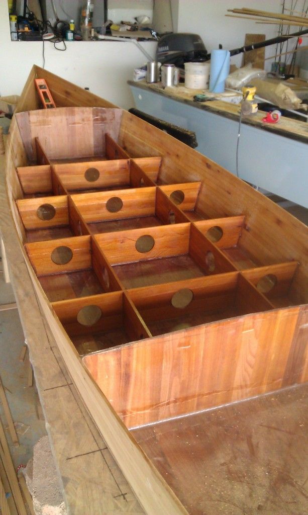

Thank you. Supports are all now in place and filleted in. I really went nuts with it, I could have just done 2 lateral supports and made it all an inch lower and it would be fine. I could have cut out more holes too, but it is good enough as is.

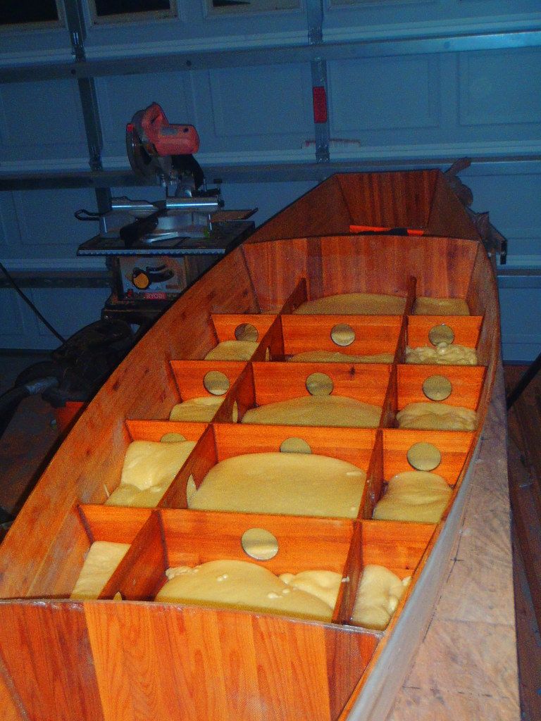

I decided to go ahead with the foaming. Really I think next time I won't bother. While it added some rigidity, I will have plenty to spare once the bottom is glassed. Between over building the interior and the foaming I think I could have saved maybe 1.5-3lbs. Not exactly detrimental, but it would have saved time and money as well. Oh well, in the end I will have a very well built and unsinkable kayak.

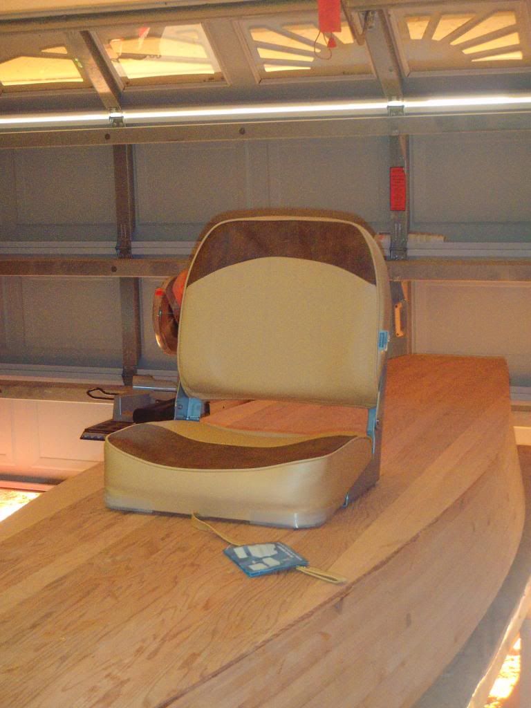

I decided the camo seat just really wasn't me, a little to (insert banjo music here). So I ordered up a new one.
