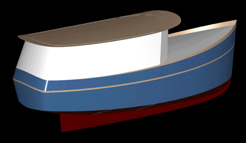

Help designing the TW34 (Trawler 34).
Posted: Tue Aug 29, 2006 1:27 pm
by jacquesmm
This is about our new trawler 34, similar in style to the TW28 except for having more volume aft (wider transom).
One of the first jobs in the design process is to collect data from similar boats. I have 6 or 7 boats in my spreadsheet but would like to see what potential builders have in mind.
So, help me collecting data.
Homework assignement:
- find one or more trawler type boats that you like
- post the URL
- get and post the following info:
- LOA or LOD (length)
- beam
- draft
- displacement
- fuel, water and holding tanks capacity
- engine size and type
No need to discuss layout or deck shape at this point. There will be at least two layouts, one with aft cabin and one sedan type.
Feel free to comment on things like desired range, top speed and other hull related specifications.

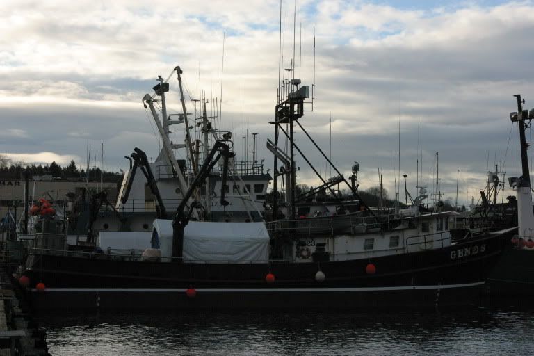

Posted: Thu Aug 31, 2006 9:15 am
by laporter
shine wrote:those are not trawlers :lol:
Yeah yeah yeah, we know. :roll: Neither are 99% of the boats listed on sites such as yachtworld.com and boats.com that claim to be "Trawlers" actually trawlers. They would be better called "Trawler Style" power cruisers but that's too many words to assimilate I guess.
By definition a trawler is: A boat which trails a net behind it to catch fish on or near the bottom of the sea. By necessity this type of fishing requires a substantially heavy vessel with adequate stability to handle the heavy rig associated with this type of fishing. Higher speeds are not normally associated with this type of vessel and most are true displacement hulls.
I can honestly say I've never seen any of the boats listed on any of those sites pulling a large net up over the transom full of fish!!
This IS a real TRAWLER

http://www.kastenmarine.com/coaster_running.jpga
It's a 40', but the line is weighted well, could enjoy a reduction to a 34/36,
add a bit more aft deck, less roof cover to set hooks when the Kings are on the herring spin.

Posted: Sun Sep 03, 2006 10:31 pm
by anonymous
Salty Dog wrote:http://www.kastenmarine.com/coaster_running.jpg
Cheers,
S.D.-
Hey SD
I exchanged a few e-mails with Mr. Kasten on this exact model. There's three different versions depending on your tastes. He suggested that it would be possible to modify the design for S&G ply construction but would be a pretty big undertaking. When I asked him about the possibility of scaling it down to 34 he was a little reluctant due to the original design specs for a double cabin and that he has other designs that would server a similar requirement in that size.
Gotta admit I really like the Coaster 40 and would love to have a widebody version someday.

The 3D "sketch is almost complete: hull completely defined, nice rounded transom, beautiful sheer line. Engine in place.
I am working on the "sedan" layout. This will be a very comfortable version with a large forward cabin followed by a large head with shower. A few steps up lead to the salon with on port side a U shaped galley with bar followed by a large L shaped settee and table. On starboard, steering followed by a wide space with maybe 2 chairs, TV cabinet in corner. Sliding doors lead to a large aft deck, all same level. The roof extends over the aft deck. There is a flying bridge with 2nd steering station, seating and room behind it for a dinghy on the roof.
Foredeck is also very roomy. All together, it looks very nice.
This is my preferred layout but there will be two others: a classic Grand Banks style with double cabin (one aft cabin and smaller saloon) and another sedan with two cabins forward. A little cramped but possible.
I need a few more days to fine tune the shape of the superstructure then the design goes to one of our associates who will produce the final model and drawings.
It will take a few months before I post the plans but we are progressing fats on thsi one.

Possible TW34 Design Interpretation,
I am not positive, but believe I have discovered a partial interpretation for the description provided by Jacques earlier. The stay sail seems a bit forward, and think the “eyesâ€
Posted: Wed Sep 20, 2006 7:49 pm
by Salty Dog
Hmmm......the photo did not post...hmmm.......there we go........
