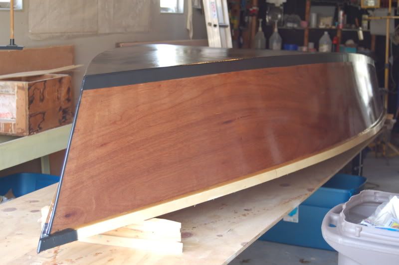

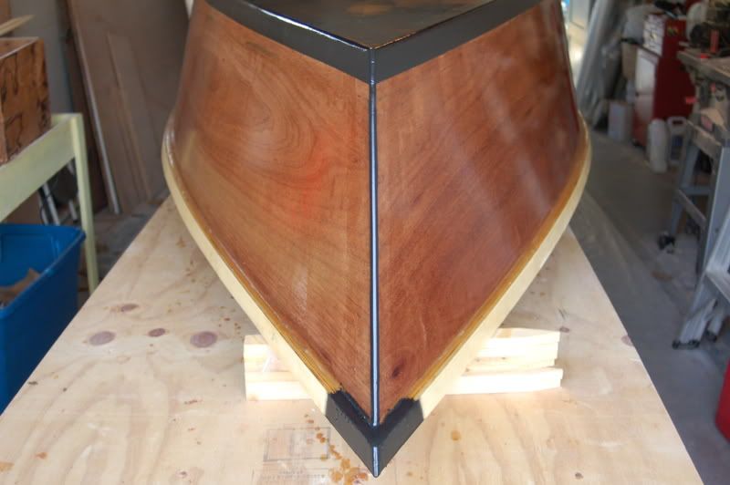

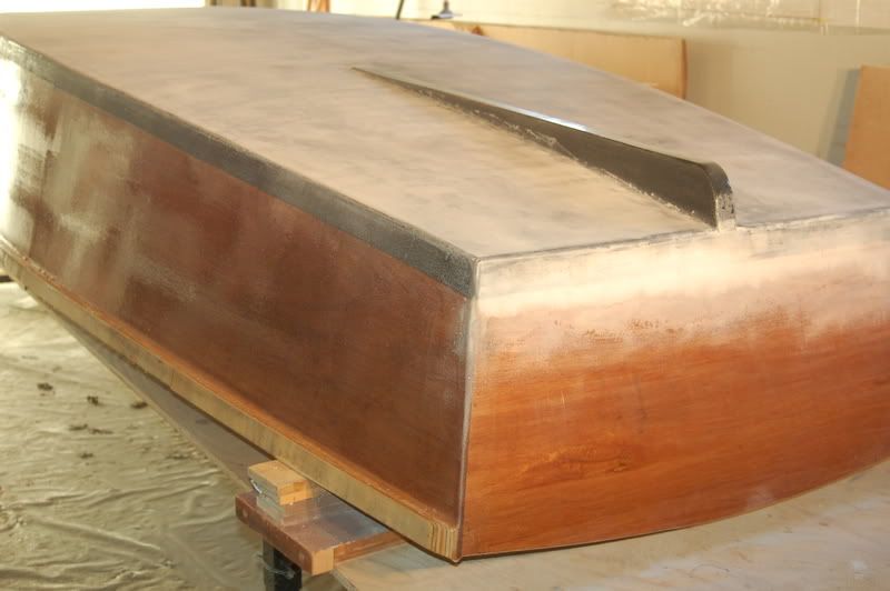

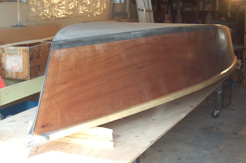

It is fast approaching now. That is to say when the Mosquito gets a paint job on her belly. After glassing the bottom, making the skeg, glassing the skeg, applying the epoxy & graphite to the bottom, and Quick Fairing the entire hull... it is time to paint very soon. by weeks end I should be there. All I have to do is decide which paint, what color, and how much of it. Some of the guys including Jacques, Tom, Justin, Boomer, KS8, and Evan have all in thier own way steered me toward the System 3. However, I need to learn a few things about the application of this stuff before I order it.
Below are a few pictures of what the Mosquito has undergone here lately.
Graphite was mixed with epoxy and applied with a roller. It looks very good and another coat should look even better.
Here we are after two coats of graphite.
Quick Fair is wonderfull stuff.
After the sides and transom are Quick Faired, It should be ready for primer. WOOO Hooo.
I know its not popular to put paint over graphite, but heres how it is. I used the graphite for tuffness. The wife likes tuff but she likes a more traditional bottom. Probably white or light blue. :roll:
