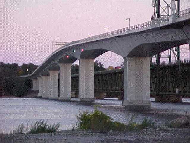

Some composite concrete modular bridges have their sections glued together with .... epoxy. Maybe its not exactly SilverTip.
No doubt some hefty through bolting may be involved too.
I liked the Old Carlton Bridge seen next to it. When it raised to let a ship pass into or out of BIW, it was a reminder of the role BIW has been in the community. Now the ships scoot under the new bridge with no fuss or muss. Not all fuss or muss is bad.
Anyway, epoxy and concrete can be effectively inseparable friends.
