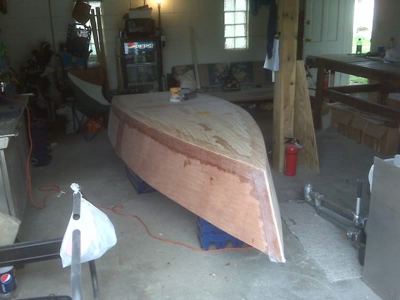

Took a few current pics taken today. Started doing some sanding because we ran out of epxoy :( I dabble in furniture making in my free time ( that was before I decided to build a boat) and I have never gone through more sand paper then I did today 8O . All in all my brother and I are having a blast putting this little puddle jumper together. The only complaint I have is having to wake up every morning and head to the office rather then head to the garage :lol: BTW does anyone want a ping pong table so I can get the damn thing out of the way :lol:

You look to be off to a great start. I bought a 3 gallon kit of epoxy and i have completely coated the entire boat. I probably used a lot more than necessary as I used a brush for the seams and a roller for all the flat areas. I also fibered the entire bottom so that required a lot more epoxy. And i added fiber to some areas of the seat tops that wasn't in the plans. I have about a quarter of resin and hardner left. I still need to make filler to place under the rubrails but i think i'll have just enough. It goes by real fast. Also, I bought the small containter of quickfair and that was enough to fair the tape seams on the inside. And i might have enought for the seams on the chines. But I do need to coat the quickfair with epoxy as well, so i'm really biting my nails.
Nice looking seams and corners by the way.

I made more progress today. I was able to cut the mid seat locker, the rub rail, PVC clamps and did some sanding. I also dry fit the rub rail to see if a 6ft pace pipe was going to be enough and also trimmed the ends to with a couple inches. I had to use a strip of 3/8 for the port side of the rub rail. When I purchased the wood one of the panels had a bit of a bend in it. Just so happens that the bend wound up on the shear line, bowing the panel into the cabin area. The three 1/4" strips just followed the contour of the bow so hence the 3/8" substitute. Ended up working like a charm! Situations like these are why I think I enjoy this project so much. If we make a mistake some where it’s correctible.
