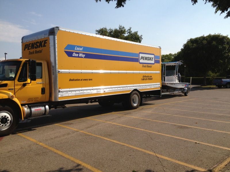

Here is the boat with the new, narrow fenders and the big yellow tow vehicle:

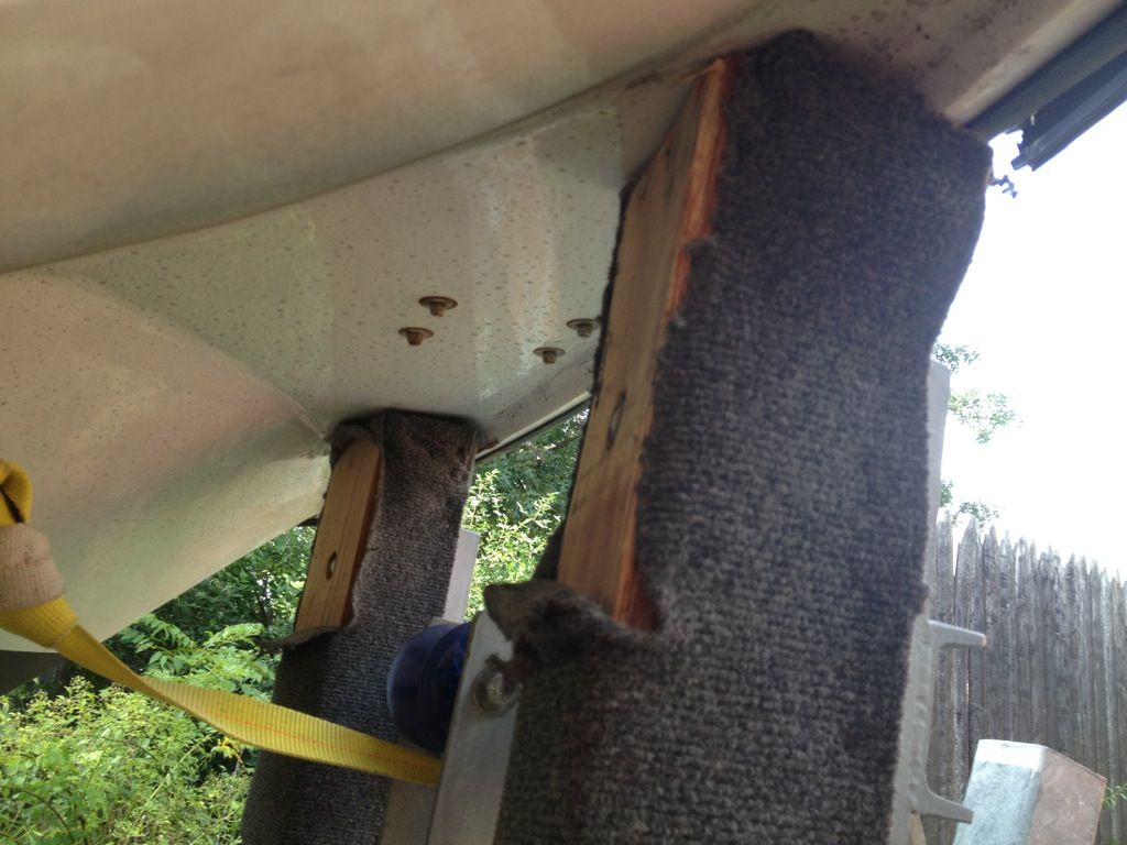

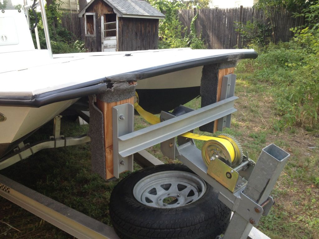

The first night, somewhere west of Little Rock, I looked back and the boat was bouncing like crazy. After several more miles of navigating through a one lane restriction with Jersey barriers on both sides, I managed to pull off on a shoulder. The winch strap had backed off and had developed a tear where it was rubbing on the cross bar. I tightened it up and made it on to the motel, but kept wondering how the strap had loosened up. More on that in a bit.
The next morning, I was cruising down the interstate somewhere between Little Rock and Knoxville when a trucker pulled beside me and made a porpoising motion with his hand and then a winding signal. I looked back and sure enough, he described it perfectly. After a few more miles I was finally able to pull off. The strap had come unstitched at the hook and was completely loose. I'm guessing that it had come partially unstitched the night before. I was able to pull a couple of feet of strap through the hook eye and tie an impressive knot. The boat rode great almost all the way to NH.

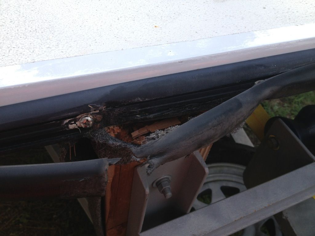

On I-84 in Connecticut, we came over a large bridge to road transition. The kind that doesn't look like much, but where the big truck bounced for about a 1/4 mile (or seemed like it). Things looked OK in the mirrors and as usual, there was no safe place to stop. The bounce was hard enough that the boat slid up and over 10" of double bumpers on the bow and rode the remaining 100 miles or so resting on the tops of the front bow stop blocks.
I'm impressed at how well the paint held up to this abuse. The port side block nibbled some material off the back of the rub rail. The starboard rub rail nibble material off the block.
Time to order 5' of rub rail, some quick fair and a few ounces of Sterling (I wish I could order a few ounces).

That's not too bad. Glad you made it safe 8)
What color is the Sterling? I've got some Matterhorn White that I could spare. I'm sure somebody here has a few ounces of the right color.

One more safety step (better late than never) I use on my boat is to use one of my dock lines to secure the bow to the trailer. Attach the dock line to the bow eye using the loop in the rope. Next, loop the tag end under the trailer frame then back up through the bow eye. Repeat until most of the dock line is taken up. Snug it as you go along and tie it off. This stops the bow from bouncing up and down. The winch strap will hold it tight to the winch post but not stop the bouncing. I wish I had a pic of what I'm trying to describe but I never considered that a pic worthy before. :?

I understand - I think that would have saved me this time around.
