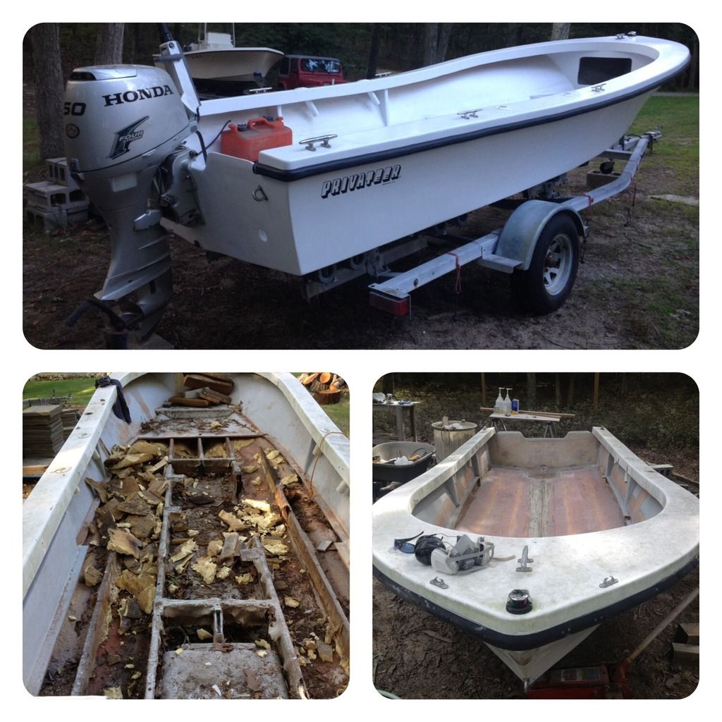

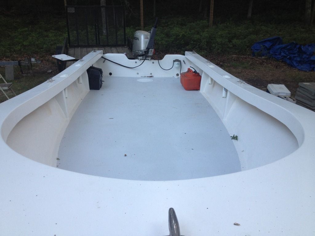

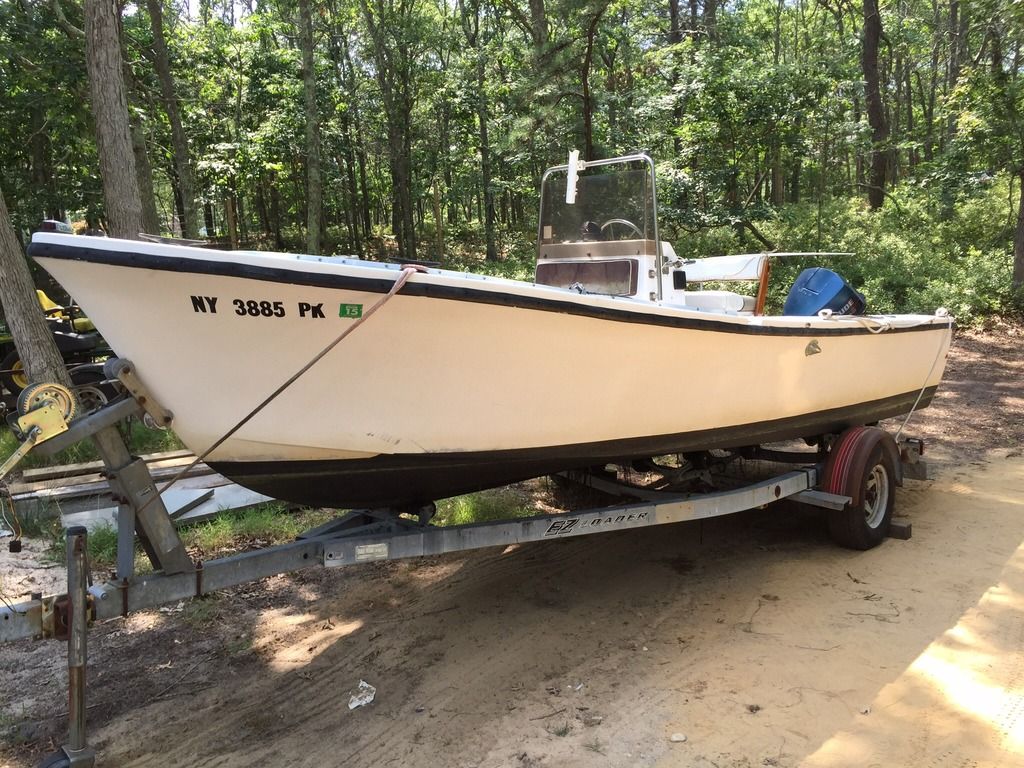

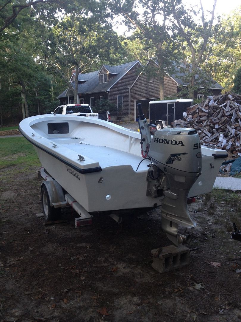

This is the finished 18 Privateer I finally completed fall of last year

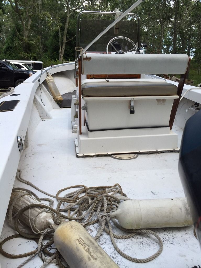

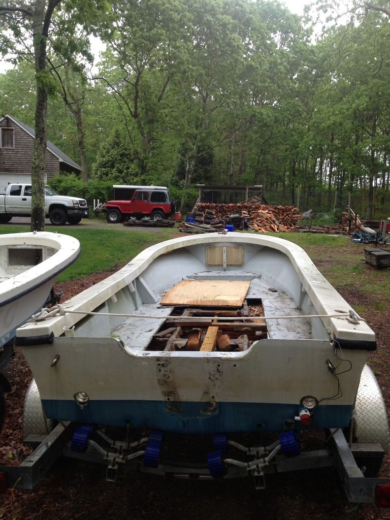

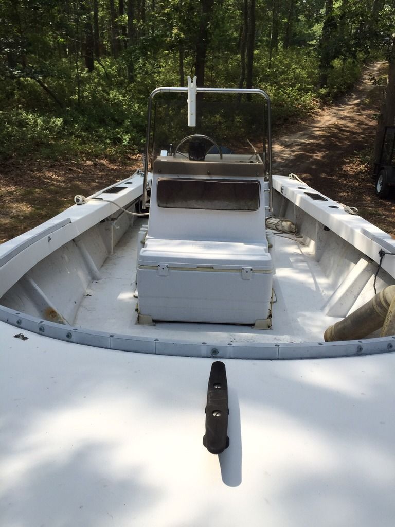

And here's the new project

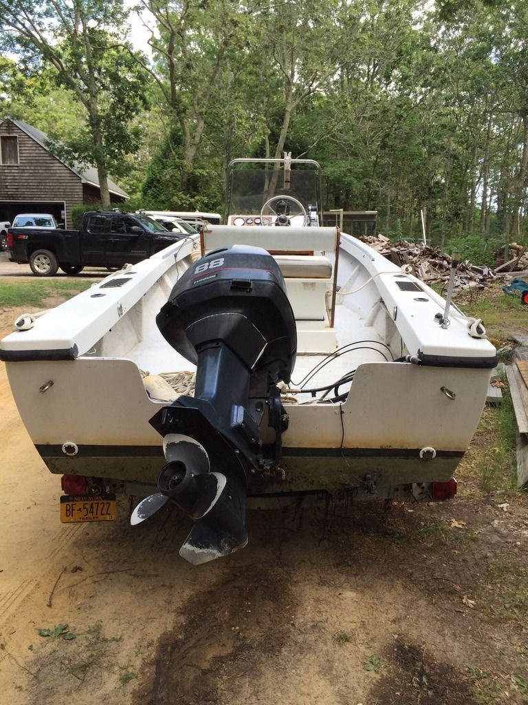

So here's the best pic I have right now of the 20 footers' transom. I think I'm just going to replace the core entirely because I'm sure it's damp from the screw holes over the years. I guess my biggest question is how I can built up the skin on the outside of the transom where the 5" will be filled in. I'll try and get a better picture from the inside to better explain. Thanks again to everyone with any input, this site has been a huge help.

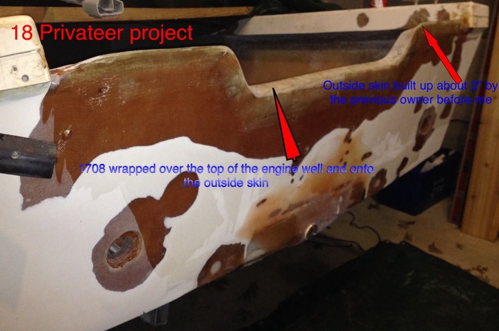

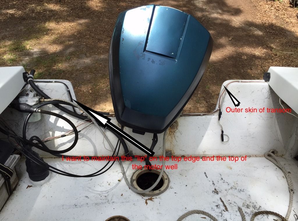

I want to try and maintain the factory "lip" that all privateers have on the outer edge of the transom. I think if I did it this way it will give me something to feather the inside skin into instead of trying to wrap the 1708 over the top and onto the outside skin. When did the 18 footer I wrapped it over the top and onto the outside without the "lip" I'm mentioning now and it was a bit of a pain to get air bubbles out because of all the angles.....
I may be wrong but I believe the only way to achieve this "lip" is to build up the outside skin with glass first, (2) lay in the plywood sole,(3) glass the sole to the hull and then go back and clean up/sand the edge from building up the 5" added outside skin layer right? I think I'm over thinking it like I did with a lot of things but I want to have a plan going in instead of winging it and learning as I go.
This is how the 18 Privateer retriever came out prior to final prep and paint. I'm not sure how the original owner raised the top of the transom by about 3" with solid glass but it definitely helped when it came time to glass in the inner layers. The lip gives the inner skin layers something to bite onto

The lip is the outside skin of the transom from what I can see. It's about 1/2" thick of solid glass
Re: 20' Privateer roamer skiff project
To rebuild it should be easy with sufficient layers of glass. To make it look neat may be challenge. It will require precise cutting of the glass layers.

in your opinion what's the best procedure to attack building that outside skin up the 5"? (1) Place a temporary backing wrapped in plastic or some other non-stick surface on the inside (2) run a single layer of glass from side to side on the outside skin, (3) let that single layer set up and finally (4) build up the thickness on the inside cutting precise pieces of glass like you mentioned prior to match the thickness of the original outside skin and then (5) finally gluing in the marine plywood with thickened epoxy?
This is where I think I lose people with my question, I'm looking for the proper procedure of building layers of glass without the assistance of a wooden sole to add rigidity while the glass/epoxy sets up.
Building a dam is probably the best way: clamp a piece of plywood covered with plastic sheeting where you want that lip to end.
I am not certain that I understand the question, could you please post a picture of the part you try to build?

You could grind a taper in the outer skin back from the edges of the cut out. Then put the dam set in from the outer skin the thickness of the skin. Fill in increasing the size of each successive layer until its flush with the outer skin and fair it in.
