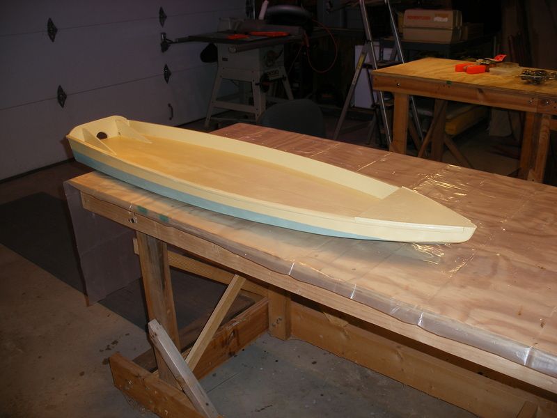

Since I'm intrigued by the FS13 I thought to make a model. l I had some scrap cheap Luan, about 3/15" I use for mockups I cut out the panels. One bottom one broke at the tip, probably because of a void, but Home Depot had some really thin sheets of something for eighth bucks so I used that. The stitch up process is very cool to do on a small scale, and it kind of teaches you how to fiddle with things. Wish I'd done this sooner. Its a 1/3rd scale, or 4" to the foot. Here's the hull with stringers:

Looks good Dougster! You've nearly got me beat :lol:
How difficult were the bottom panels up at the bow to join? Mine are pretty stiff but I have not played with them too much yet.

Gramps wrote: How difficult were the bottom panels up at the bow to join? Mine are pretty stiff but I have not played with them too much yet.
It's easy at full scale but you will have problems with any scaled model unless you use very thin ply like veneer 1/16".
I specify 4 mm, if you scale donw to 1/4, that means 1mm ply = 40 th. 1"

by Dougster
Once I used the thin doorskin stuff (about 1/8" thick) the bow stitched up pretty well. What worked best for me was following the notes and Cracker Larry's way of loosely putting in the zip ties, then locking in the transom with a few screws, getting it set just right, then working forward, tightening up the zip ties with the dowels shown in the pic.

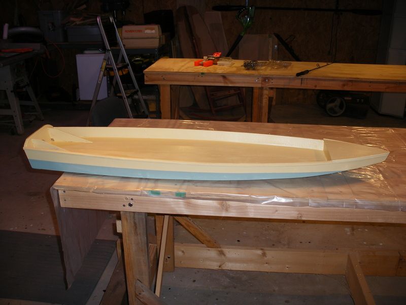

by Dougster
I just noticed Cape Man's last post :lol: I did finally get around to finishing the model, and even found some old paint. Here' a couple of pics.
It was a fun project. Now, given the two larger size choices I wonder about the pros and cons of each size. Maybe I'll post that on Jacques thread showing them.
