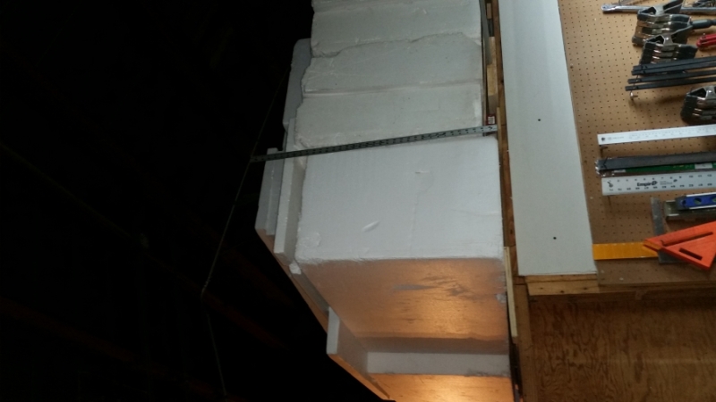

To cut the foam I use nickel-chromium wire. Most art supply store sell it in 48" lengths and less than $5.00. I run a #8X32 bolts through 2- 1"X2" and clamp them to my work bench vertical and attach nuts washers and wind the wire around the bolts a few times and tighten with the nuts. I then attach a variable voltage supply to each end and adjust power to get a good cut. 2"x4" clamped on as a fence and slow push the blocks through the wire. Can adjust the 1"x2"s to make different angles and no white "dust" at all. To fast and the wire will break, to much voltage and the wire burns up. Endless possibilities on cutting foam. Can even make a scroll knife this way!
My collection.
