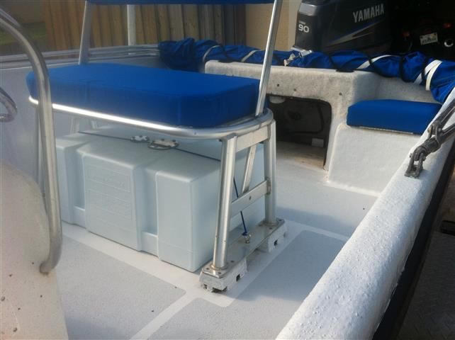

I applied it with a cigar style roller cover to the top of the paddle board, and its very comfortable. Its easy to adjust the texture by using more/less product and different roller covers
sorry I dont have a close up, but here it is...

OK sounds good.
Do you have anything at the shop that is coated with it I could check out? Or some sample cards? I may be able to swing up there Friday afternoon.
I think I'd still want to splatter over the non-kiwi areas to break up the texture, particularly in the taped corners. Maybe a white base with grey splatters, and grey kiwigrip on the standing areas. I'm tempted to repaint the entire interior.

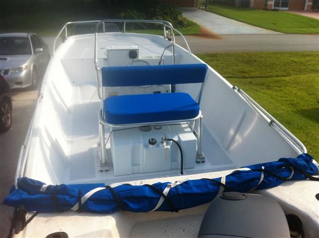

Still knocking off odd jobs here and there.
Latest is kiwi-gripping the rest of the sole, and installing a Moeller 22gal above-deck tank. I hate those 6gal Tempo tanks that it replaced. No more plastic fittings that leak, and having to switch tanks during the day. Plus twice the capacity.
Really happy with the deck. Only screwed up one area, just a few square inches were exposed to the sun and the Kiwi kicked off fast, so it bridged a bit when I pulled the tape. Think it should be an easy repair.
